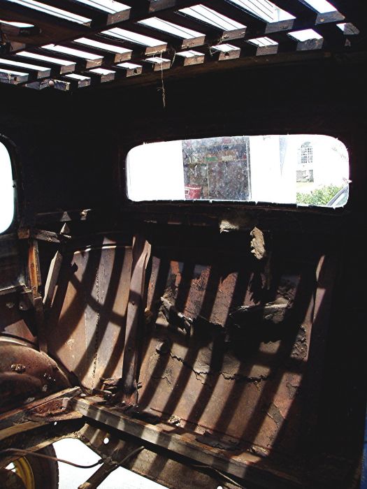

My attempts in fitting together the wooden pieces with the other parts every now and then brings me to a point where I think, what is going on here.
Chistech you are right that this is a puzzle but this one where the parts just do not fit together as nice and neatly as you would like them to fit. Now I am at the back of the car trying to put together the rear window frame with the other rear parts. And here I discovered that I do not figure out where the two metal supports should be mounted to. In the photos I made at dismantling it looks like they would support the rear belt rail from the bottom. But for this now they look about 1” too long.
https://vccachat.org/gallery/48/medium/16325.jpg
But they also do not fit between the belt rail and the rear window frame.

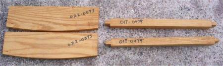

And here I have wooden parts of which I just do not know where they go and how they are supposed to fit
https://vccachat.org/gallery/48/medium/16327.jpg
022-0573 are called “Rear end sill to body brace” in the invoice.
017-0474 are supposed to be parts of the rear window frame, but that one seems to me already complete.
My request is if anybody can help me in any of these mysteries which puzzle me at the moment.
The ideal case would be if somebody can supply me photos of the correct mounting of the rear wooden parts. Any help is highly appreciated.

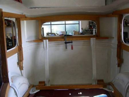

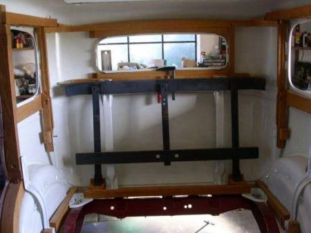

the 2 pieces 022-0573 attach to the 2 metal supports that attach under the rear window frame. If you can enlarge the attached photo, you see the 2 support arms going from the rear cross sill to the bottom of the rear window lower belt. Your wood (0573) would replace the piece that are under the 2 screws. The other 2 can't ID yet. Hope that helps.

I just noticed that the 22 support arms at jpeg 16326 are sitting on TOP of the blocks that your rear seat locks to. The supports should be to the inside of the block (almost touching the block) and under the lower belt bar.

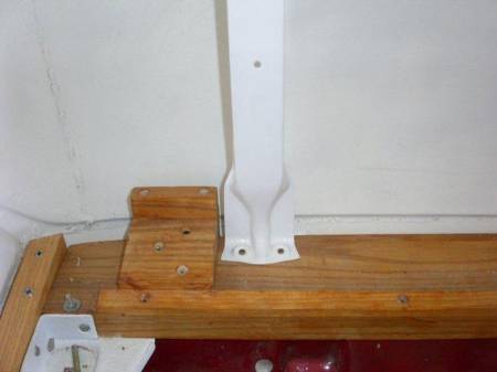

My thanks go to nhinchas for the photo and the explanations. It is a pity that this photo is not very clear in the details when I enlarge it. I am also not quite sure if I understood your explanations correctly. So please let me go through this point by point.

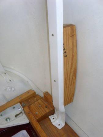

Does this show the correct placing of the rear metal supports at the bottom?
https://vccachat.org/gallery/48/medium/16362.jpg

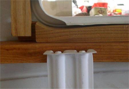

Does this show the correct placing of the rear metal supports at the top?
https://vccachat.org/gallery/48/medium/16363.jpg
Does this show the correct placing of the “Rear end sill to body brace”?
https://vccachat.org/gallery/48/medium/16364.jpg
If the above questions can be answered with yes, then I get to the problem which I am facing.

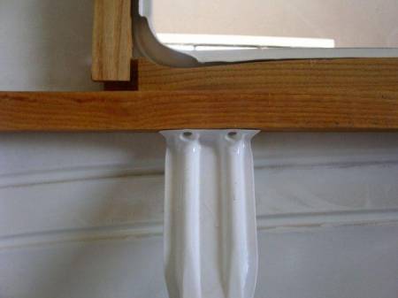

When I place the metal support bar correctly at the bottom, then the top looks like this
https://vccachat.org/gallery/48/medium/16365.jpg
It seems the metal supports are just too long, or the two wooden pieces above them are too thick.
Maybe I need to make the lower rear window frame piece a bit smaller?
Maybe I need to make a cutout in the rear window lower belt?
Or a combination of both?
Any suggestions are welcome and generally any good photo of the correct installation of the rear wooden pieces would be highly appreciated.

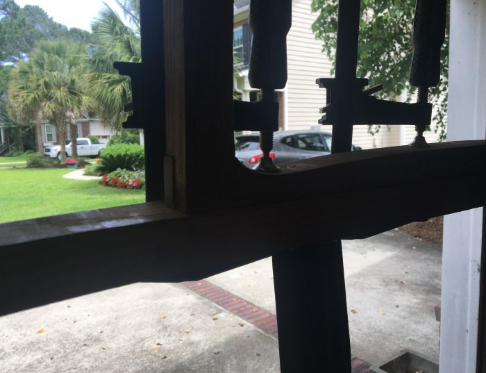

In your picture 16365, your window frame is not connected at the bottom joint (the joint should be flush, see my pics Window Frame # 1 and 3). That will lift the lower belt bar to allow the metal support to fit.
