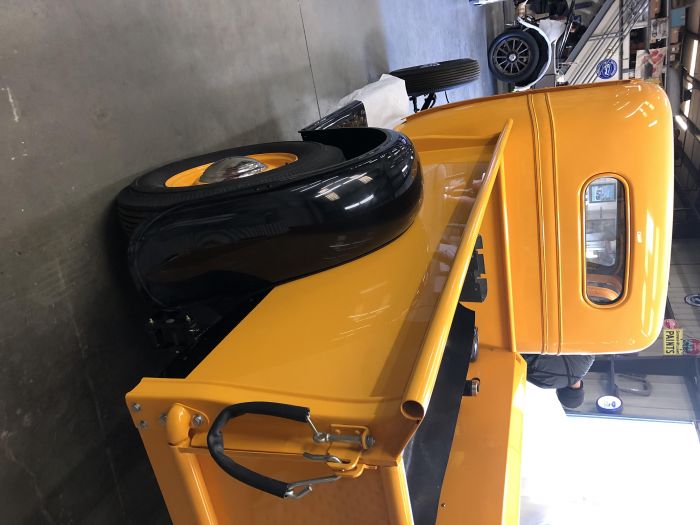

I used HD “S” hooks for the 34’ I just finished. Those double J loops never seem to want to lay flat. It’s a driver and not a show truck so cosmetics are not as important where utility is. It got a 37’ rear, shortened 6.5 on the torque tube/ driveshaft, spring shackles moved in 1 7/8”, hydraulic brakes with the 37’ fronts a direct bolt up to the 34’ axle. I found and installed a 36’ pedal/master cylinder bracket with all new lines, cylinders, and hoses. This truck goes down the road really nice and stops even better. Full interior now too.

I'm thinking about making up sets of the heavy canvas chain socks shown in my pictures above and offering them for sale. They are much nicer than the stiff hose most use. I'm thinking brown and black. Do you think there would be a market for them?
I would be interested in a pair, the rubber ones that the parts houses have are ok but I like the looks of your snazzy ones!
