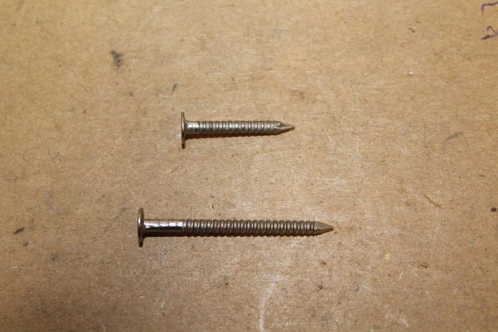

I too was looking for nails to reattach the wooden roof to the metal portions of 48 station wagon that I am working on. The original spiral nails are 3/4” long with a .080 diameter shank. The head on the original nails is .150 diameter. A fellow member of this forum suggested that I contact Lang’s Old Car Parts that supplies Model T parts and order their item number B-NAIL1. Here are a couple pictures of the nails that I purchased from Lang’s. You can see the replacement nails are also 3/4” long and the shank also measures .080. The head of the replacement nails is .187 diameter. They may have other sizes. Mike

So I got a picture from Gary Wallace and he is suppling flat head nails which is not what is needed. Having said that these could be used for attaching the sheetmateal to the underside of the main and floor sills. At the moment I have been using the countersunk ones offered by Model A suppliers but have to grind the heads to the correct size.

Mike, I’m glad Don was able to help you out. Those nails appear to be the closest I’ve seen. The countersunk head nail is really no longer made, at least the way we need them. I spoke with a customer of mine who has nails made for him and the amount needed for a special run is ridiculous so I do the best I can and actually save nails that are good for the areas that show.
