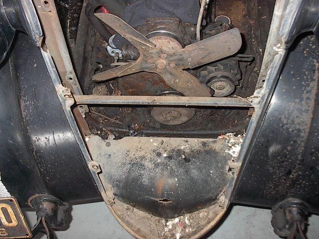

Welcome to Chat! You came to the right place. I hope you decide to join the club and meet up with us on tours. I don't know how the connection on a 36 truck compares to my 38 car but I'm attaching an image showing the core support where the radiator mounts. On my car it simply bolts to the core support. The connection points are on the flange just in front of the fan. I'm sure someone with personal knowledge of a 36 truck will be along shortly if they're not the same.

In your pic you show a "flange" or mounting surface on the left and right that a new radiator would bolt onto. My 36 truck seems to be missing that if in fact that is an added piece to the radiator shroud. The radiator installed in my truck has that mounting flange attached to the radiator the bolts run left and right not front to back if that makes sense.
Photos would help. Since you're not a club member you can't embed them in your post so you'll need to upload them to a third party hosting site then post links.

Thank you, It appears that I am missing the strip of metal that the radiator connects to. It must have been removed to make room for the master radiator since it basically comes with it's own shroud/mounts attached to the radiator.
