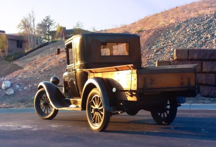

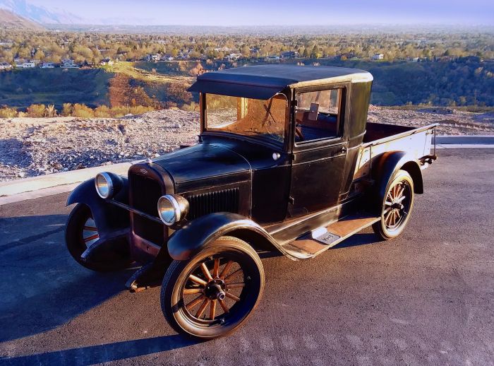

I recently purchased what I believe is a 1927 Chevy sedan truck conversion. I'm giving it to a friend for the summer for local car shows & parades etc.
My friend is in poor health and I want to make the truck as reliable and trouble free as possible. The 1928 engine runs great and was rebuilt not too long ago.
The previous owner said it could get hot sitting in traffic after a while in 90*+ weather.
I have found 6 volt electric fans I could probably get to work if I removed the factory fan. I would rather not use modern components if I have a choice.
It has a two bladed factory fan now. Is there a four blade fan that will bolt up to the '28 engine? I noticed some '28 cars have fan shrouds, but also have the room to fit them - doesn't look like it on the '27.
When parked after driving, there are usually a few ounces of coolant that overflows. If I wanted to install a temperature gauge under the dash, where on the '28 engine could I mount a sending unit? Anyway, any tips for optimum summer cooling appreciated.
