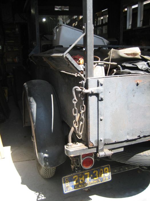

Here are some pics from my truck bed.
IMG_7953.JPG IMG_7957.JPG IMG_7958.JPG IMG_7959.JPG IMG_7960.JPG IMG_7961.JPG IMG_7962.JPG IMG_7965.JPG IMG_7966.JPG IMG_7967.JPG
Our '28 1/2 ton Canopy Express is the same construction as Dean's. Ours has the rectangular window behind the door that Dean's does not have. Both are Hercules bodied. All the other '28 Canopy Express bodies I have seen have Hercules bodies.

These are very helpful pictures. What is picture 7 of? Between the dimensions on the Hercules page and these pictures I should be able to duplicate something when the time comes. The only thing I would need to know is thickness. I'm assuming the flare boards are a 1in board? Then I would need to know the thickness of the finished sides, and tailgate.
I have searched the web quite a bit, and have yet to find brackets that are close to those. The guys making a Model T wood bed kit have some of their brackets that are close, but not quite.
I can make some of them myself as I am a welder/fabricator by trade. We will see where I take it.

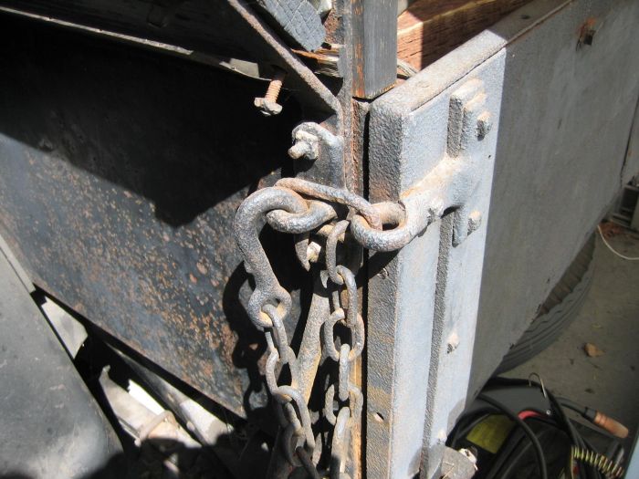

Photos 5, 6, and 7 are three pics of the same part.
Five shows the top of the angled rail support. Six shows it horizontally going under the flair board and over the top of the bed side. Seven shows the support going down the inside of the bed to the bed floor.
Most of the metal parts are made from 1/4" x 1 1/4" flat bar steel. The flair board itself is 5 1/2" x 3/4", with a 3/4x3/4x1/8 angle iron screwed to the top (to protect the top edge).

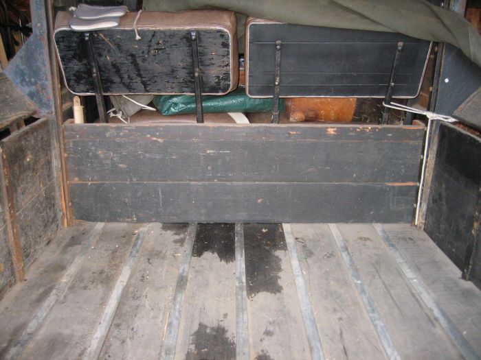

Last Saturday I took my '28 Canopy Express to a swap meet so I cleared my tools and show accessories out the bed.
Here are some pics of the empty bed.
IMG_8001.JPG IMG_8003.JPG IMG_8004.JPG IMG_8006.JPG IMG_8007.JPG IMG_8009.JPG IMG_8010.JPG IMG_8013.JPG IMG_8014.JPG

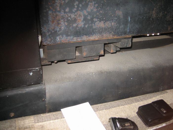

Also curious how the underside is framed. Now this may be different as I am thinking the canopy express is built like a 1/2 ton on a car chassis, and I am looking at doing this for a 1-ton truck, but it would be good for reference I'm sure.

Tony, thanks for the kind words. I'd say roughly 1/3 of the wood is original and the other 2/3 was replaced by the previous owner (PO). Luckily, he worked on it for over 50 years while it resided in his garage and kept it out of the elements. ;-) In general, he seemed to keep to the original design, but in some areas, he did some pretty hokey stuff.
Along the hokey stuff line, there is a noticeable error with the outside edge bed boards and aluminum bed strips. If you look closely at the sixth photo above (IMG_8009.JPG), you'll see that the outside edge bed board is raised slightly (about 5/8 inch). That board is being pushed up by the rear axle hump in the chassis. Either the PO didn't raise the bed enough to clear the hump or there should be a hole in the underside of that board for the hump to stick up into. Both the right and left outermost boards have the same problem. At the moment, I am at a loss for how to fix these errors because I do not want to disassemble the whole interlocking body just to rework these two boards. ;-(
David, below are some more photos. Yes, the side armor (sheet metal cover) is bent and nailed to the top, bottom and end edges. As you can see in the pics, the inside surface of the bed side is not armored. I do not know if the sheet metal was glued to the outside-facing surface of the boards or not, but the sheet metal is flat and tight against the boards and there are no nail heads showing.
The inside width of the bed is 45 inches and the height of the sides are indeed 14 inches. The thickness of the side boards and rail boards are 3/4 inch.
Speaking of the rail boards, I noticed that they are pointed at the bottom (I didn't see this before). I made a cross-section drawing of a rail board to show the dimensions, the point at the bottom, and the dimensions of the angle iron that is screwed to the top. BTW, the angle iron is set into the wood rails.
As an aside, the flat bed of my '27 one ton truck is built upon two long boards on edge (7 inches by 1 3/4 inches) that have a curve cut into them to fit over the rear axle hump in the chassis. Attached below is a pic of that set up.

I wonder how much of what we are looking at as far as the underside frame work is from the PO. if he replaced the floor boards and strips it is likely he could have replaced the supporting frame work, and it is not the way it was made originally. It seems odd to me that they would just have those 2-2x4s just floating under there. It appears obvious that the underframe is only the 1.5, or 1.75in (whatever those underframe boards are) above the highest hump in the frame. Then there is the added spacer timber(s) up in the front to level things out (again depending on how high that hump is)
And I need to keep in mind that the hump height on my 1-ton chassis is more than likely higher than your canopy express chassis. I will have to what there is for holes in strategic places along the frame, and take a good straight edge and see how high that axle hump is.
Going back to the artist rendition on the 3/28 post it is portrayed that none of that side framing is seen suggesting that they would have put a metal conceal strip over it to hide it all and make it look nice or the steel cladding on the side would have extended down more in the front to hide it unlike what we see in your 5 of 9 picture Dean. I would be shooting for the artistic rendition. It also appears that there is a hand painted pinstripe on the sides.
Going back to your box Dean, it appears that the 4 vertical steel straps have threaded studs on the bottoms that bolt down through the frame boards that run the width. Is this so? Is that to say then that there are only 4 frame boards that go side to side that the 3/4in floor boards attach to?
