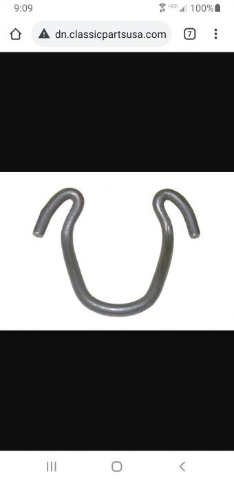

Do I need one of these to clip into the cup?
The Master Parts List indicates that the socket is an integral part of the clutch arm. It does not indicate that Chevy ever provided a socket as a service part.
The aftermarket might have provided such a part but I have never seen or heard of one.
The spring keeps the arm on the ball.
That socket appears to be welded in so I would not consider it as an obtainable replacement part on its own, with the arm attached may well be hard enough to find.
