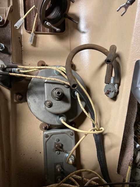

here is a picture of a dash I'm working on now, I agree disconnect battery before starting to remove the speedometer. as noted there are three lights and speedometer drive to disconnect and should be 4 nuts to remove gauge.

Firecars, great under dash photo. Thanks very much. Sure looks much cleaner than mine. Also enjoyed the picture of your car. Hope you don't mind, will send you a PM with some questions about your car. Bob
