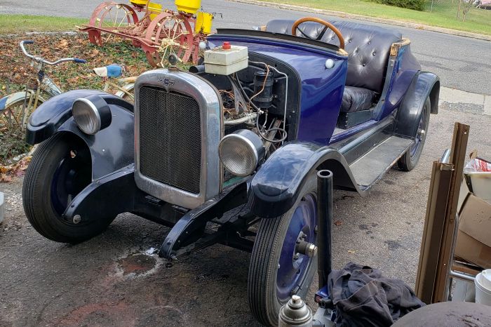

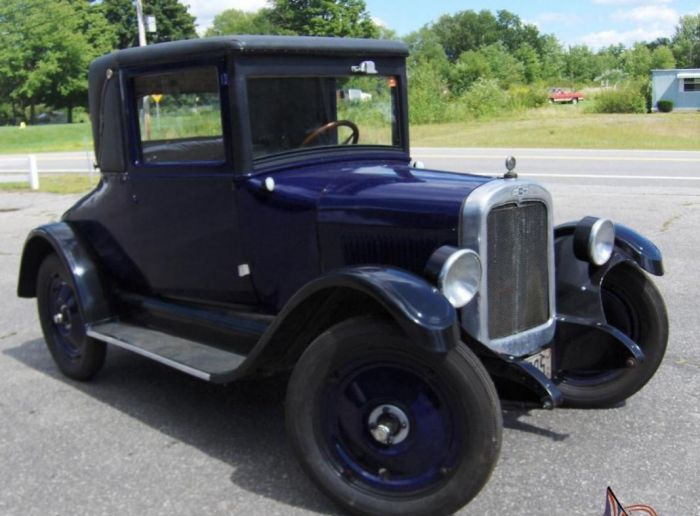

I appreciate all the advice given to me but I suddenly dropped off to take a break from the car since it has turned out to be such a disappointment. It was supposed to be a running driving vehicle that someone cut the roof off. What I found was overheating,cracked head and block that were jb welded over,non working fuel system,non working oil pump and after fixing the oil pump and driving it around for a few ten minute trips the rear blew up because it not set up right and the ring and pinion were way too far apart from each other. Even the parts chassis I bought from another source was a disappointment though I am going to use the rear out of it,so thats a plus if it works. I was about to take any offer just to recoup something and buy another project but I am ready to give it another go. If the rear does not work out I am giving up on the idea of tooling around in my little 26hp car and going to just put a newer drivetrain in it. Attached are pics of what I am dealing with at the moment and the other is one I found of the car when it was for sale some time ago. Maybe I can give it some kind of new life since it was so badly abused. Many questions to come hopefully!

Your car looks great to me and getting that simple mechanical stuff together should be easy, given that you can find parts.
Take advantage of the priceless experience on here and go for it!
Many will be cheering and when you get a top on it you can even drive in the rain.
Please post more pictures, mechanical and body. I have no four cylinder experience, other than Model A.

Looks like your car originally had a wooden structure for a "faux" convertible top. If you can find some windshield posts from another closed car, you might not be as far from "correct" as you think.
