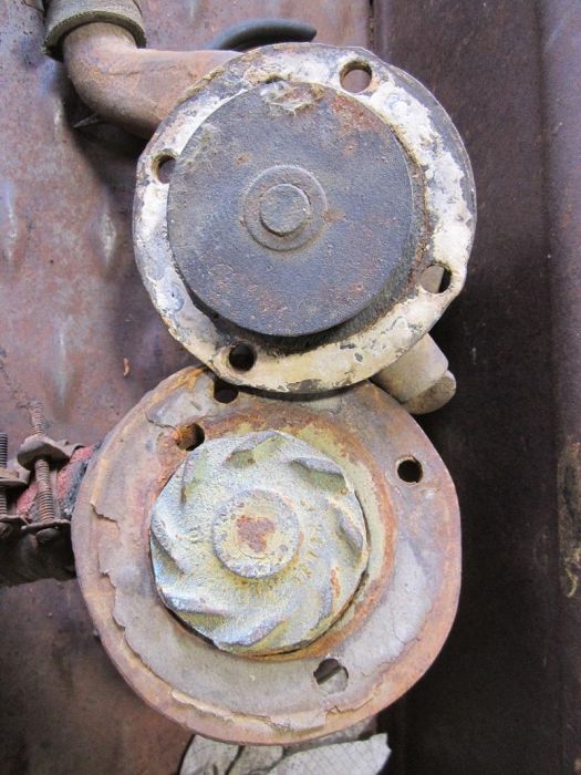

These are off the two motors each with different empellers. The bottom one has the oil drip flap intact and both have the grease cap. Which is better?

The top pump has the correct impeller,but the bottom one looks like it has a 6cyl impellor on it.

Going by your photo, the impeller fitted to the pump on the bottom is not correct for a 4 cylinder Chev.
It may be of a 1929 or later.
