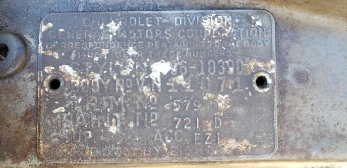

I've always wanted a 4door hardtop. Its in a very RURAL area of AZ... about 2 hr drive. Before I make the haul out there I want to be prepared. Thanks in advance for your feedback.
Biggest question: What engine and transmission did it have? Can you tell by the bellhousing or data plate?
What do you think guys? :)

Peter based on the hood "V" and the fact that the transmission is still in the car, a 265 cu. in. V-8 and Powerglide transmssion. Also only a single brake pedal and no clutch pedal. The photo of the engine compartment shows a cut radiator support crossbar. The original V-8 radiator mounted behind the crossbar and 6 cylinder in front of the bar. The radiator position suggests a replacement engine was installed. Overall the car looks to be very restorable.

"no rust on this car. The rear fenders had the lip removed at some point to put bigger wheels and tires. The car is a factory powerglide tranny. The engine would have been a small block 265. Floors and trunk are immaculate."
NADA and HAGERTY values it at $8500 but thats a driver. $6500 isnt unreasonable, but considering overall condition, lack of an engine, needing a windshield, and remote location (2 hrs from Tucson, 3 from Phoenix, and 5 Albq. I dont think he's gonna get a lot of nibbles). (Could be wrong) I hope the guy has some wiggle room.
"#4 vehicles are daily drivers, with flaws visible to the naked eye. The chrome might have pitting or scratches, the windshield might be chipped. Paintwork is imperfect, and perhaps the body has a minor dent. Split seams or a cracked dash, where applicable, might be present. No major parts are missing, but the wheels could differ from the originals, or other non-stock additions might be present. A #4 vehicle can also be a deteriorated restoration. "Fair" is the one word that describes a #4 vehicle."
