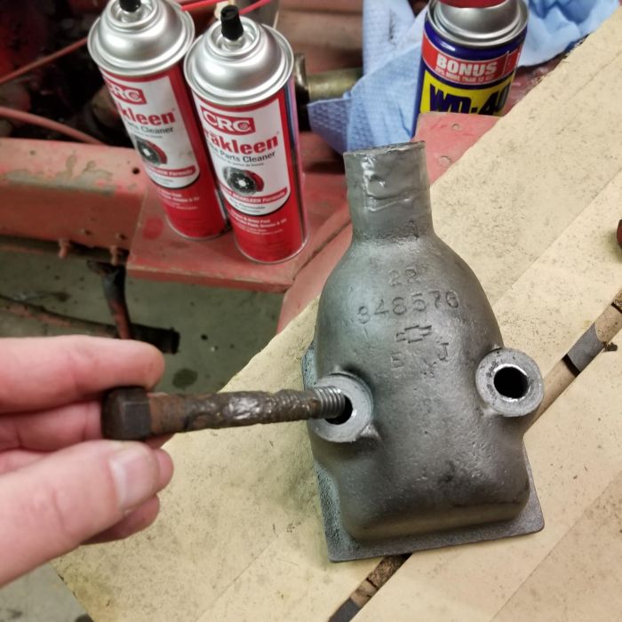

Anyone know the size and thread type for the thermostat bolts? (I am not good with thread pitch type and size)
also I will go to the parts store and see if they have a bunch of copper washers that are used on brake lines to try and get actual part number to post once i find bolts to size them up to.

The thermostat housing is off a 1928 Chev 4 passenger car,and the bolt part number is: #108619 Hex Head Cap Screw 7/16" UNC 14TPI X 2 3/4" length
CJP'S 29
I suggest you take the old bolts with you to the hardware store to match them to new ones (both threads and length).
The '28 thermostat housing in Lurch's engine took 3/8-16 (3/8 inch diameter and 16 threads per inch) bolts. I bought brass new ones to help them not to corrode.
I also used 1/4-20 brass bolts inside the housing to hold the thermostat bracket down. Here's that part of the rebuild story: Resurrecting a '28 4 banger - thermostat

Thanks, mine was a 7/16" UNC 14TPI X 2 3/4" length.
The ardware stores did not have it as they all skiped from 2 1/2' length to 3" and the online did also (just googeling) so i stoped at a machine shop and they gave me 2 new bolts.
the machinest did mention the 2 3/4' ones are hard to find.
i went to the auto parts store and got a Dorman brand copper brake hose washer to fit over the bolt.
Finding 7/16" hardware of any length is difficult. As far as the odd lengths used on some of the old cars a lot of time chasing can be saved by getting longer lengths and threading as necessary. Standard capscrews are threaded two and a half times the diameter. Investing in a good quality tap and die set will pay for itself many times over.

Another invaluable resource for a lot of odd ball parts and pieces is McMaster-Carr, I hate to think how much money I've spent with them over the last couple years. For instance, they have stainless steel 7/16" UNC 14TPI X 2 3/4" bolts off the shelf, items typically arrive at your door in a day or two:
https://www.mcmaster.com/92198A680/
(just a side note, if you ever use stainless steel bolts with a grey cast iron casting, I'd recommend using a little anti-seize on the threads)
