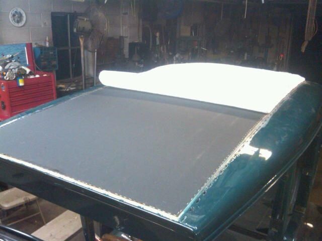

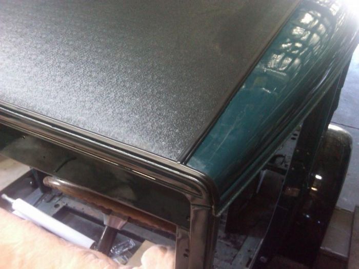

believe it is a short grain cobra vinyl at least that what used on my 1929
and it has 2 under layers one black originally a burlap i believe, then the cushion layer, then the vinyl
readily available all over since it was used on many cars, especially the T, measure length & width
I dont know anything about material types but a friend worked with upholstery and advised to add at least 6" to all measurements over 2 feet, his theory is 6" extra before starting is a lot cheaper a complete thing when you cut wrong.

Like Jerry mentioned, there is two layers of material below the roofing. Many years back, some used smaller mesh chicken wire as the support layer. There’s even a way that the chicken wire was used as an early radio antenna when the roof was replaced. Either way, the first layer is a fairly strong material like the chicken wire or a denim like material but used a thinner synthetic that doesn’t absorb water as a precaution down the road. The layer on top of the first was originally a thin cotton type wadding and today a 1/8-3/16” foam is used. It gets trimmed shy of the molding area so when the edge molding is put on, there is a gentle taper of the roofing material. I use a spray adhesive to hold the foam down to the bottom material to keep it in place. Remember to tack your first layer in a few places along the center roof slats especially when using chicken wire. If the wire is not tacked in the center, driving down the road with the windows open makes the roof puff up and down with the chicken wire making “ticking” sounds the whole time.
