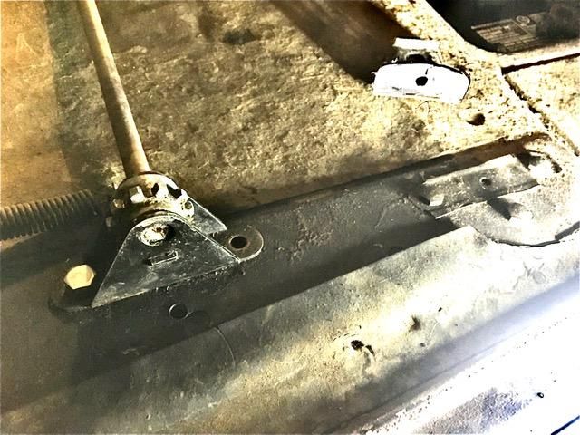

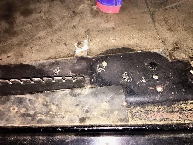

When taking the 38 for the purchase test drive, I noticed I could not move the seat close enough to sit back and touch pedals so I drove 38 sitting on the edge of the seat just to reach pedals. I assumed it was a simple fix, something was probably jamming the mechanism, was I wrong. I discovered the prior Nebraska owner literally moved the entire Mechanism about five inches aft by drilling new holes for mounting seat rails, etc... I immediately
commenced to removing all of the hardware from top and below, big fun. Upon breaking seat mechanism loose, I found a couple of spare parts, good times. About eight hours later, I thought I had her together including spare parts only to discover front of seat is not secured and tilts back, not anchored(spare parts not installed correctly. I decided to address another situation and take break from the seat, car starts once only then can't start again as though the battery is dead, weird.

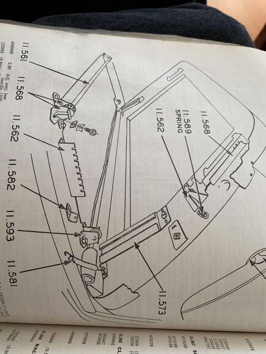

Here is the exploded diagram from the parts manual. I've seen a better picture in one of the manuals but couldn't find it.

Looks the same and that’s how reinstalled them but the bracket that holds the front not swat came out. I haven’t even looked under because of the starting issue or ”˜lack of starting”˜ Issue

Nice, 11.568 was not in the tracks fully so it popped out, she’s good now. Thank you for image

If any of the hardware was still in place it’s because the prior owner didn’t use them but instead drilled a bunch of new holes to reposition seat assembly back abut 5 inches. It was mostly easy to put back to original positions except they added a rod to the spring and repositioned the rear roller assembly but I wouldn’t know until I had to secure then it relaxes I had to readjust roller assembly too. Not easy by myself but I finally got it done with everyone’s help.

The 11.568 is the piece I was referring to but didn't have the drawing or number to reference.The upper tab slips into the channel to prevent the tipping.
