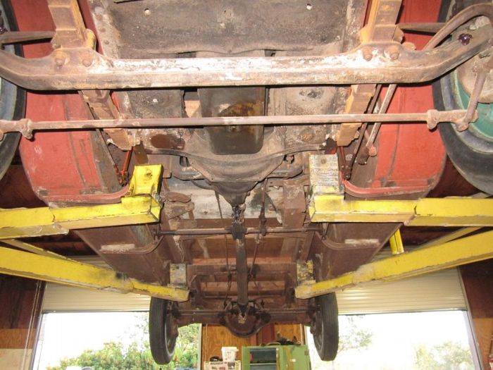

Got it on the lift. About 2 hours of soaking, brushing threads, adjusting brakes; we have 3.5 tires that stop and a nice pedal. Clutch feels good and all shifts work. Driver front brake needs more love/grease etc but we could drive it if we had ignition parts. Start pulling body apart as some 92 year old wood needs help. Need a ebrake return spring, 1 rim bolt, and 2 rear axle threaded cap covers. Of course 4 tires. Phish
I have a can with some rim bolts and keepers from previous one ton trucks that I've owned.
There were a few different styles of the keepers, so if you post a photo of one of yours, I'll see if I have one that matches. If I recall, most of mine are Jaxon keepers.
Out in todays mail: Cap, Rotor, Points Condenser, Rim bolt and lug.
This lug is the plain one with no markings. It matches my '28 truck. The bolt is a bit shorter than mine but should be long enough to use, at least temporarily. You will need a 7/16 fine thread nut.

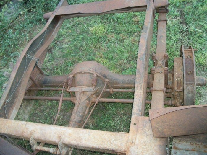

Black (RUST) Friday. Did some last minute buy it now shopping for some missing parts. EBAY charges tax now! Scored 4 blade fan, fuel delivery system, exhaust stove, oil filter EXTRA MOTOR etc and a complete1 ton chassis with bad wheels. There are 3 or 4 other vehicles of that era to dig in so let me know if some parts are needed. We roll this weekend, 830 miles. Plan on making a hillbilly truck out of the remains and probably sell the correct 28 LP 1 ton after it is perfect. All in Phish
Yes, each State has started charging sales tax this past year and they make Ebay collect it on their behalf. Some cool pieces you got!
