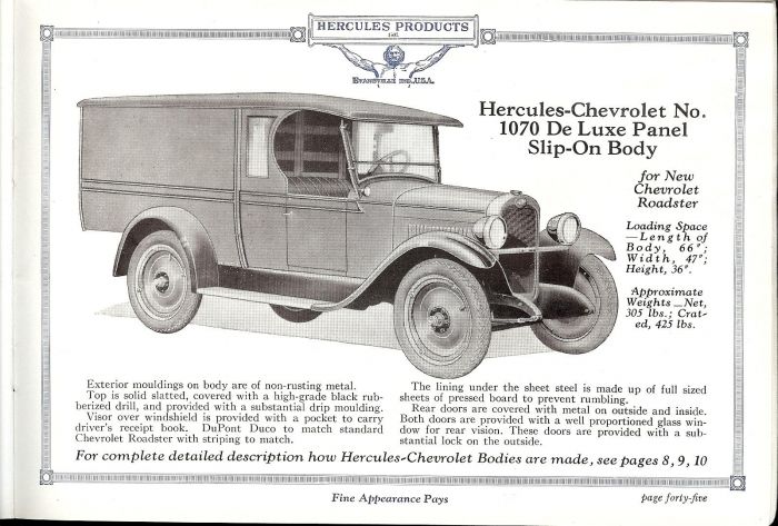

I've got a '28 Hercules Canopy Express body on my '28 1/2 ton truck. Some of the wood is original and some was replaced by the previous owner. I'd be happy to take some pics for you.

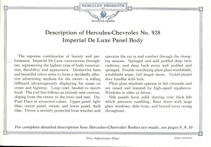

Attached are a couple of photos from the 1928 Hercules catalog. Both have the word Deluxe in the title. It looks like one is made for the 1 1/2 ton truck chassis and the other is a body that can go onto a roadster body.

A few years ago someone had listed one of the 1070 models for sale. I had thought at the time it might have been somewhat homemade because it had the roadster embossed lines on the body and looked like an old fashioned "C" cab. I wouldn't have thought there would have been such a truck made commercially that new (27/28). Your Hercules catalog is a great source of information to decode the past. Thank you for posting it. Art

Hi again,
There are some pages in the Hercules catalog that talk about the body construction and show some pics. There is also a picture of the underside of the seat cushions. I used this visual info to make seat cushions for my '28.
