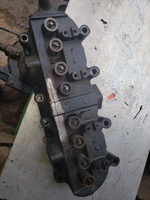

Oil pressure resolved finally with a new pump. Next is that it overheats at idle in driveway. I have not driven it farther than a few blocks so I only assume it will overheat driving also. Radiator did not seem to flow well so I flushed it with a hose and now water seems to pour out faster than you can put it in with a hose. Started it with upper hose off the radiator and water seems to gush out after a few seconds. I had seen a thread about putting a restrictor plate in so tried a temporary go at it with a washer in the hose with an 11/16 dia hole through, It made no difference. I also tried a shop fan in front of radiator and no change. Lower rad hose feels cosiderably cooler than upper which leads me to believe the radiator is doing its job. There is a crack in the top surface of head,carb side midway back and in the block half way down carb side. Someone jb welded over these and then painted the engine hiding it. I have not really noticed the block leaking but the head dribbles a tad when running till warmed up. These will have to be addressed later in another thread if the over heating problem is solved. I think it seems to run too well to scrap the whole deal. Any help would be greatly appreciated.

Head is off and the crack in the head looks simple and straight forward. The block is very hard to tell whats what but looks like it is a mess with some spots looking like there is braise and others not. I dont think that the block really leaked so will leave that for now. There is at least 1/2" of crud in the bottom of water jacket. I will try and scrape,vacuum and rinse it clean and do the radiator again. Now to figure out how to weld the head.
You can also fix the head by cold welding it. It's an electric weld with nickle rod and not really cold... but you never weld for long enough that you can't put your hand on the area a minute or so after you stop welding. Once you know how to do it it's not too hard. It helps if you have a little welding experience though. And it helps to be able to preheat the entire head a bit before you start. It's a very strong repair when done right.

So I finally got the head back. I had him leave the bead without grinding it hoping it would not leak. It still leaks so I will have him go over it one more time. It also still over heats, even after flushing out all the rust and sediment while the head was off. Very disappointing but will carry on . I will try a washer in the rad hose to see if slowing the flow will help. One positive is that i think the Stewart vacuum fuel pump is now working properly after a cleaning and new gasket
