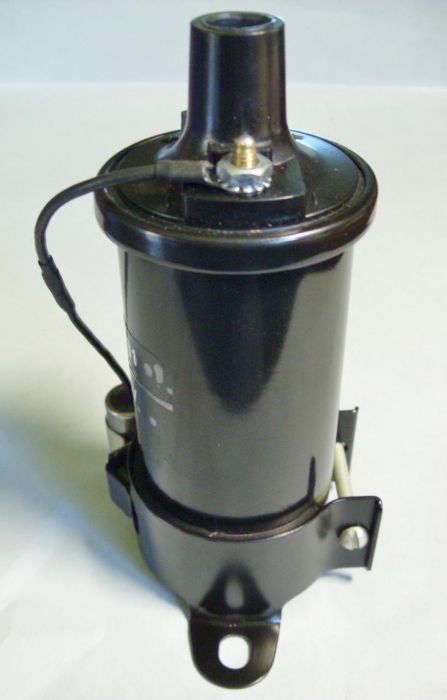

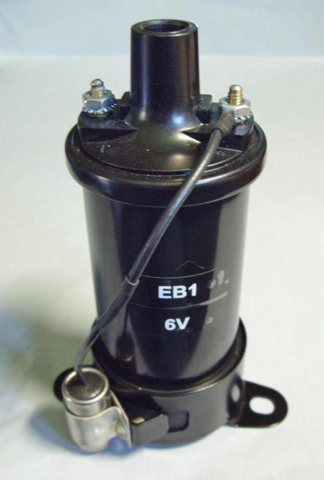

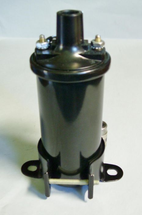

Hello All
Just to let you all know that the coil listed in the picture has a max rating of 60,000 volt but it does not take 60,000 volts to fire the spark plug every time. it all depends upon the spark plug wire resistance, rotor tip to distributor cap contact clearance, spark plug gap and cylinder compression pressures. A well tuned engine will only require about 15-20,000 max secondary voltage to fire the spark plug depending upon the afore mentioned conditions. The best thing about a high output coil is that it will run cooler at lower outputs compared to a coil with less winding that is only rated at 20,000 volt output. Most modern 12 volt regular point operated coils are rated at 35,000 volts.
We sell a ready made to install replacement coil kit to fit 1922-28 Chevy 4 engines. This kit is modeled after the coil kit the aftermarket such as Niehoff made probably 70-80 years ago. The kit comes with a 6 volt copper wound oil filled premium coil rated at 55,000 volts, a 2 eared bracket that bolts right up to the original coil support bracket and the appropriate condenser to work with this coil. The condenser is made for GM vehicles with the correct microfarad capacity. This coil kit is priced at $85.00. Attached are a few pictures of this coil kit.
I used my archaic tester for testing coils with a drill operated distributor and 6 volt battery on this high output coil. Just by holding the spark plug wire away from the distributor housing, I can get a blue spark from 1 1/4-1 1/2 inches long. With out the spark plug wire in the high tension tower and operating the distributor, I can get a blue spark from the terminal inside the tower to the negative terminal on the coil.
