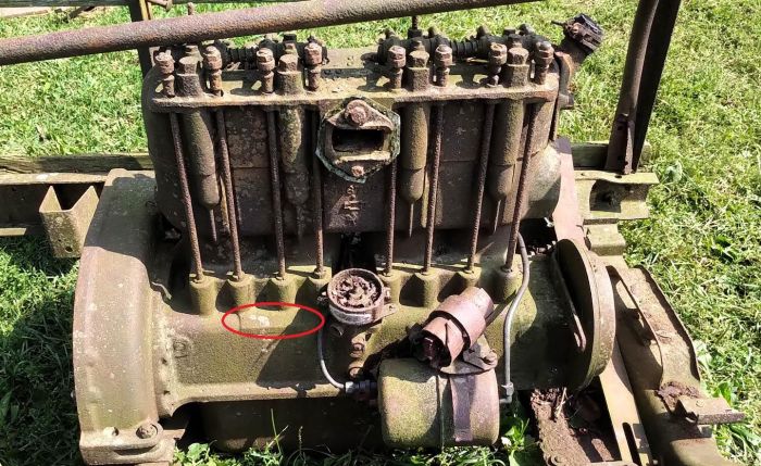

Here is another try at posting links to the pictures of the engine.
Keith
That is a 1928 block with a 1927 head. I would suppose that the iron worms have already taken their toll.
devil Agrin
I have a different take on the numbers than AntiqueMechanic's in his post above.
The cast date on the block (F 27 8) does indicate that it was cast on June 27, 1928. However, according to past discussions, the block number (846709) is for 1926 or 1927. This seems correct to me because the distributor is in the middle of the block and the block does not have the raised rails for the 1928 push rod covers.
Again, based on previous discussions on these forums, the head part number, 407, indicates that it is for an early Model H or Model 490. Maybe 1914 - 1919.

Dean,
I would agree with you about it being a 27 block or earlier since that the block dose not have the bolt holes for the push rod shields. What is intriguing me the most is the serial number stamped into the block I don't see them or I'm just not looking hard enough.

I suspect that the flat spot where the serial number would be stamped is directly to the left of the distributor. See the attached pic. I circled the area.
Keith, you'll probably need to take a wire brush to that flat spot in order to see the characters stamped into the steel. They might have a letter in the front with seven numbers following it. If you find it, we can give you more info.

I have no idea what this might mean?
Also, thanks to All for your replies. The consensus seems to be though the head was changed at some point to an earlier one, likely simply because one was available and better than what was on it at the time.
I will try to clean that area to find some additional info.
