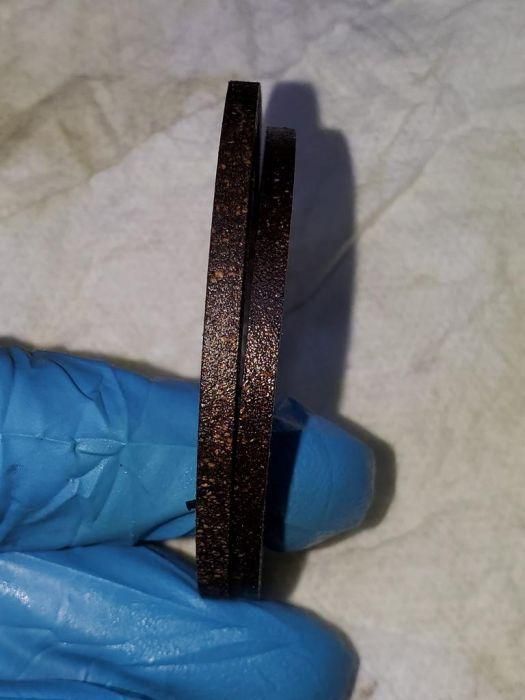

Originally Posted by swk1
Just talked with our supplier of fuel pump kits. They changed to a cork-rubber composite gasket for the fuel bowl about 6 months ago
would explain why the kit i bought about a year ago to do my 1929 has a different looking bowl gasket then the last 2 i have bought.
the first kit bought for my 1929 looks like a solid black rubber, not a composite and has worked great. the last 2 kits i bought (one for spare fuel pump i got and one for the 1930 fuel pump rebuild) look like a composite. they are nearly black as you can see in the picture but look to have some small amount of cork (brown in them) and a different feel to them. the FG-1 Cork-Neoprene i also purchased looks like the traditional cork composite, brown with a few specs of black in it. that is the one i was going to try next in the fuel pump.
thinking of doing a bench test. put a little bit of gas in a pan and then drop in the gasket let it sit and see what happens. also do the same for the one from the kits. measure before and after see how much it grows :)

the composition one was used from the kit in the rebuild for the 1930 fuel pump it is the one that swelled and pushed itself out of position.removed it and then put int he other one from the spare fuel pump that had the same composition gasket in it. picture attached is the first swollen gasket removed from the 1930 and the one i pulled from my spare fuel pump before installing it. once they dry out the return to normal size. but once installed and exposed to fuel this is what happens within 15 minutes.

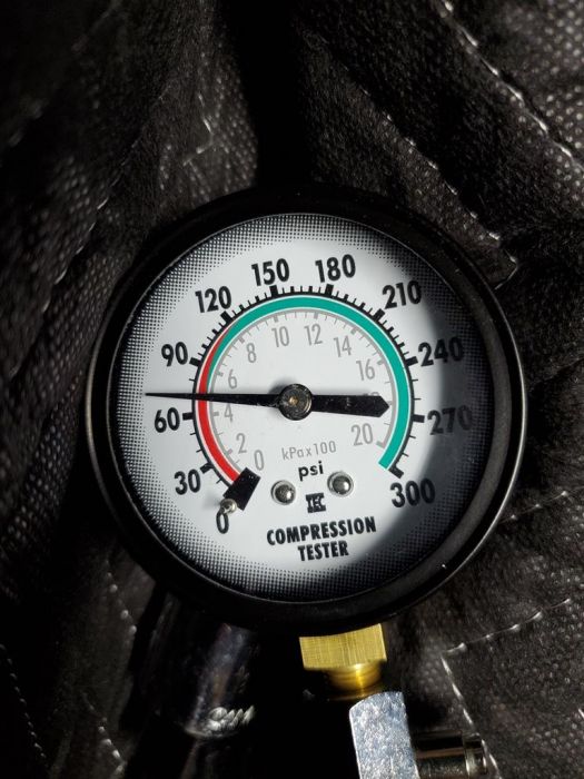

decided to pull the plugs, check them and do a compression test... ran the cylinders twice, and not the same cylinder twice in a row !!
Compression Test:
Cyl 1: 55
Cyl 2: 70
Cyl 3: 75
Cyl 4: 75
Cyl 5: 60
Cyl 6: 70
1930 Cylinder 1 2020-09-12.jpg 1930 Cylinder 2 2020-09-12.jpg 1930 Cylinder 3 2020-09-12.jpg 1930 Cylinder 4 2020-09-12.jpg 1930 Cylinder 5 2020-09-12.jpg 1930 Cylinder 6 2020-09-12.jpg

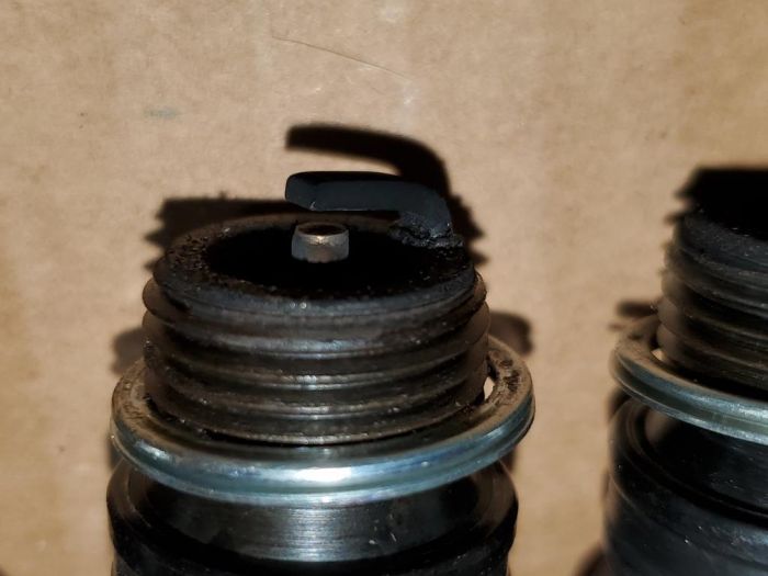

Then took a look at the plugs:
pictures a labeled number and a/b
cylinders 1-3
1930 Plug 1a 2020-09-12.jpg 1930 Plug 1b 2020-09-12.jpg 1930 Plug 2a 2020-09-12.jpg 1930 Plug 2b 2020-09-12.jpg 1930 Plug 3a 2020-09-12.jpg 1930 Plug 3b 2020-09-12.jpg
cylinders 4-6
1930 Plug 4a 2020-09-12.jpg 1930 Plug 4b 2020-09-12.jpg 1930 Plug 5a 2020-09-12.jpg 1930 Plug 5b 2020-09-12.jpg 1930 Plug 6a 2020-09-12.jpg 1930 Plug 6b 2020-09-12.jpg
all plugs in line cylinder 1-6 (left to right)
