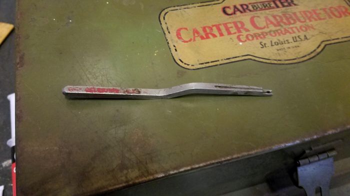

This was in my Carter Carb tool kit and to me it looks home made but of high quality. I have no idea what it is for but would love to know.
Similar to some old typewriter tools, it looks like a "c" clip installer. Clip should snap into groove of tool and be able to push on.
Thanks Greg, that sounds right.
