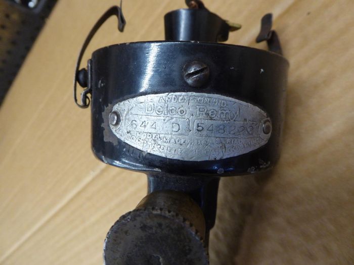

644D is for a 1933 Chev. It is the first year with a vacuum advance.

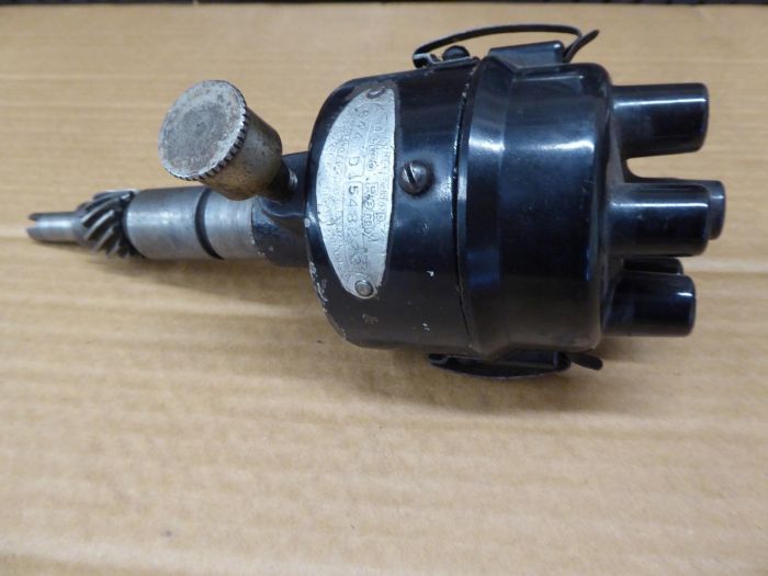

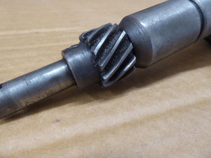

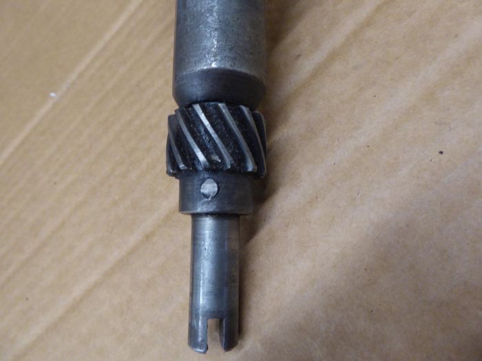

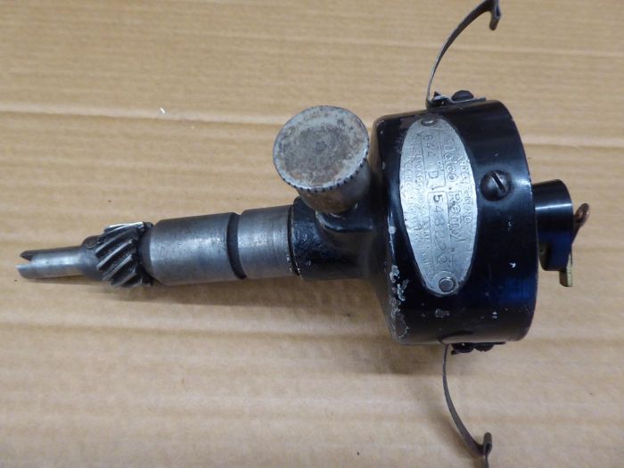

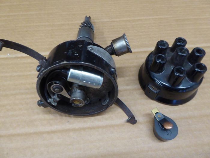

Hi Steve. Here are some pictures of my 644D distributor. It appears to be in good shape and the shaft turns freely.
I don't know if the gear is the same as you need for a 1930. The teeth do not show much wear so I think it could be used.
The gear will rotate on the shaft for a short distance so perhaps the mounting pin or the pin hole in the shaft is worn,but there is no external evidence of damage or looseness of the pin and I haven't tried to take it apart.
Let me know if interested. I'll sell the complete distributor as shown for $35 plus $15 for USPS priority shipping.
Tom

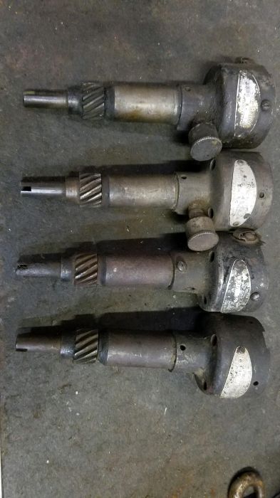

Here are a few 633G distributors. Looks like your 644 has a groove cut in the body and the grease cup is in a different spot. You can see the wear in the gears is in a hour glass shape, worst on the bottom.

I will take it Tom.
