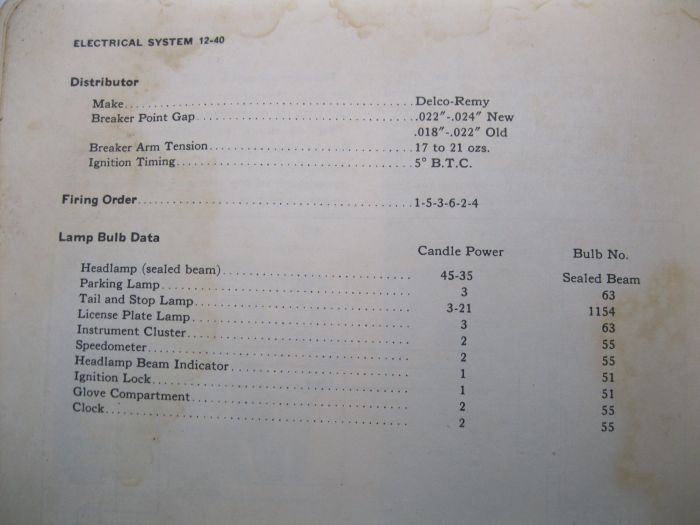

Hello: I would like to find a printable light bulb chart that shows the number and location of what bulb goes where for a 1947 Stylemaster 4 dr.I want to replace all my old bulbs with the correct ones and upgrade some to LED

It is is the owners manual On page 37 of my 1946 manual so a 1947 should be on the same page.
parking lamp #63 bulb if no turn signals
Parking lamp and tail light 1154
licenseight #63
Ignition lock light and high beam light #51
Instrument lights #55
dome light #82
Rather than install new bulbs i WOULD JUST KEEP SPARES IN THE GLOVE BOX SO YOU HAVE A SUPPLY HANDY.
The 1154 is themost frequently needed bulb.

Hello Chev Nut: Thank you for the information.I looked in my '42-'48 shop manual and could find the chart. Next step is locate a 1947 owner manual.

[Linked Image from vccachat.org][Linked Image from vccachat.org]This is in my shop manual on the last page.
