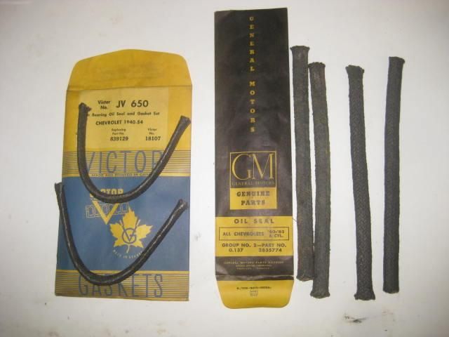

P.S. I BELIEVE THE BEST REPLACEMENT SEAL IS THE OLD VICTOR SEAL STILL AVAILABLE ON EBAY
VICTOR Rear Seal
VICTOR rear Seal

These are the NOS rear seals I am talking about as most dependable.
Thanks, Mike
