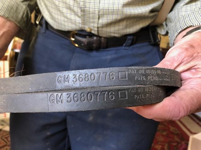

The angle is also a bit different on the two belts. If you want the absolute correct fitting belt, go to your local store and see if they can interchange the old Gates number, which is 700. When I say old, I mean prior to the mid 1980s.
Gates 700 is the belt for Model A Fords and all Chevrolets from 1937 until they changed to the narrow belt in the early 50s.
I am not sure on the cog deduction. This one had GM and the part number molded into the belt.

Dave: Now that's interesting. Must say I never saw one of those. I know replacement belts made now come with cogs. Wonder what time period GM sold these? (Gene, want to comment on this since you are an ex parts manager) I believe our 30s, 40s & early 50s Chevs would have come from the factory with no-cog belts If the VCCA/AACA judging criteria is to have the car as it came from factory/dealer I would think they would expect to see a no-cog belt. Think I will make copies of your pics to keep in the car in case any judge wants to deduct points for using belt with cogs. Any experience judges out there want to comment on this ??

I think I would dispute the cog deduction as well. The cogs are a little more rounded than the modern coged belts. I will check the sleeve for a date but my grandfather passed in 63 and the belt looks like it was riding around in his car with him for some time.

No date but it shows application data up to 54, so between 54 and 63.
The cog type belts came on some 1952 models and were sold by Chevrolet for replacement in the mid 1950's. That is the wide 1937-1952 passenger car belt. For judging as usual it is generally overlooked.
The cars got the narrow belt in 1953 but the wide belt was still used for truck applications.
Chevrolet and GM did not make belts but used products like Dayco, etc.
