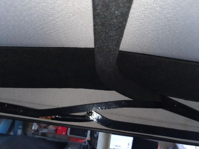

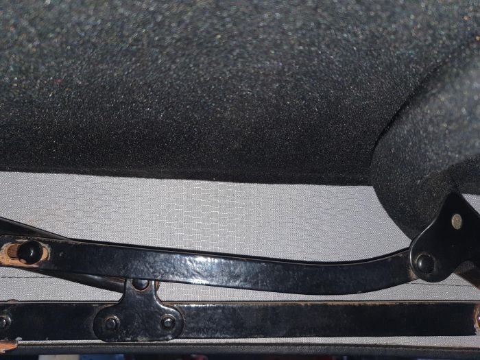

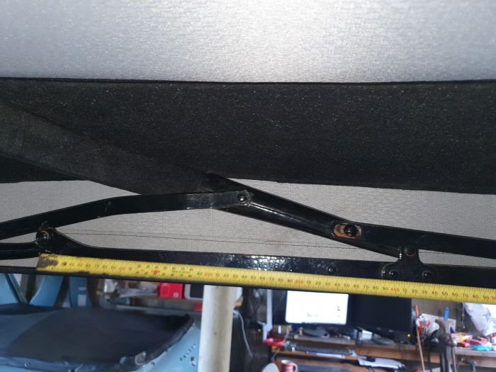

Hello Dave,
Have attached some images,
Hope this helps
20200416_153326_resized.jpg 20200416_153340_resized.jpg 20200416_153358_resized.jpg 20200416_153413_resized.jpg
Posts: 44
DaveT Offline OP
Posts: 44
Thanks Jobbo for the pictures. They raise the next question. In some configurations the second bow from the front attaches onto the flat bar directly and in other pictures it attaches to a little "T" bracket which is rivetted to the flat bar. Did this vary by year or maybe by country. The pictures that I have of South African roof irons seem to be riveted directly to the flat bar although the sample I have has the little bracket. Trying to scale from a photograph is difficult because of distortion, but it appears as if the flat bar is about 650mm long on the "T" bracket examples and only 585mm long when the bow is attached directly. I wonder if the roof irons were not included in the export kits? Any comments from the US?
