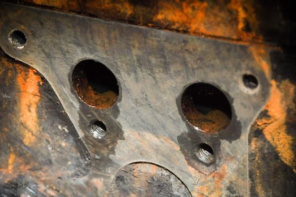

The 1941 engine had two water circulation holes on the back where is meets up with the block, the1937-1940 had only one. The pump rotor was larger in 1941 and that pump was used righht up into 1954. The 1955 was completely different. The extra large water pump rotor mounted right into a very large opening in the front of the block. In 1955 a new fan with larger blades was used but it turneed slower to reduce fan noise.
Awesome info.
That 2 hole vs 1 hole waterpump backing plate always has me scratching my head. It sure looks like a 1941 up waterpump could be used on a 37-39 with a single hole backing plate? The reason I question this is 1941 up water pumps are very easy to find but the 1937-39-40 pumps are much harder to find.
Attached is a picture of my block that has a single large hole being a December 37 casting. It looks like I could (in theory) open up that one single hole into a huge oval and use a 2 hole waterpump or backplate.
There is also a large plug right below this water pump inlet hole (my engine) or holes (1941 image) that opens right into the water jacket. I can get several fingers inside the single hole in my block all the way down to this large hole that will end up with a plug installed. It sure looks like the block and backing plate could be opened up for way more flow. Not that I plan to, but the single hole could at least be chamfered a bit to direct water flow to the sides of the block.
The biggest difference I see with the 2 hole design is that each hole sends coolant cleanly down the outside of each cylinder and the 1 hole hits the first cylinder and then the coolant has to decide whether to go left or right and I'm sure one side gets considerably more flow than the other.

The one hole and two hole backing plates are different in size and the attachment holes are different. I think the two hole design came out to direct flow down both sides of the block. That one hole is larger or similar to the area offered by an open thermostat so it shouldn't represent a higher restriction.
Thanks. The mounting hole spacing is all I can figure. I had a couple 2 hole waterpumps but tossed them years ago. Wish I had them to look at.
I had a handful of loose back plates and recall all the holes lined up other than the obvious 2 but don't fully trust my memory. The hole spacing sure LOOKS the same overall.
Edit: seem to now recall Gene pointing out hole spacing to Rusty and I in a thread a while back. Memory kinda works. Sometimes...
Edit 2: Found a pic online where someone overlayed a single hole plate over a double hole block and painted the outline - attached. Height of two holes is likely important for flow to top of block...
