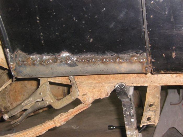

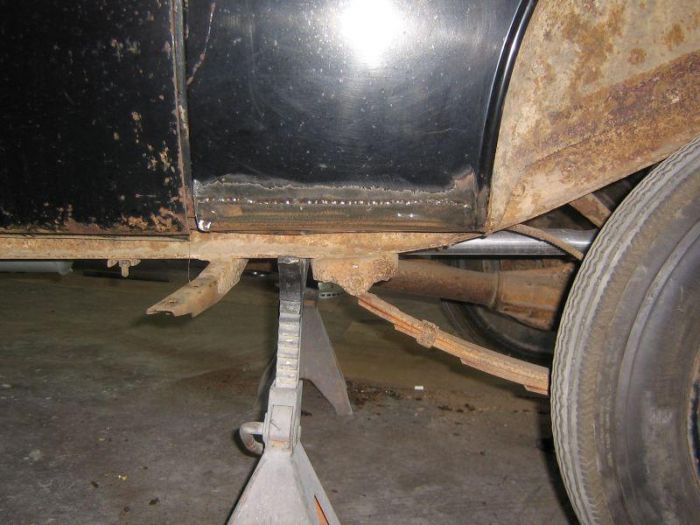

While I slept last night my brain decided that I should bug my friend to take some measurements relative to the frame on his car. His needs restoration but between both our cars I should be able to get something close enough to tweak fit during assembly.
I don't know if this will help or not.
Thanks Tiny, Yours are nice and simple without the weird angles like mine but I'm curious to compare the locations. Always great to see your pictures as your car looks like my twin and gives me hope that someday all these parts will once again be assembled into something...
