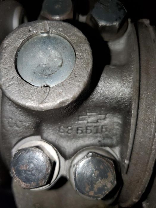

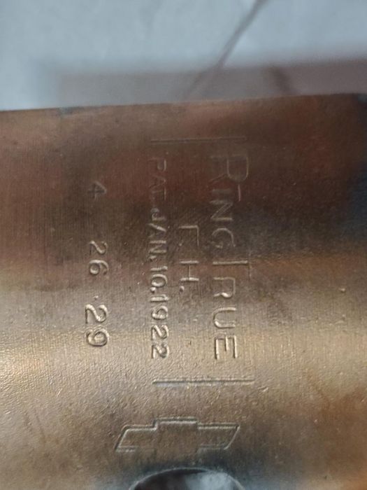

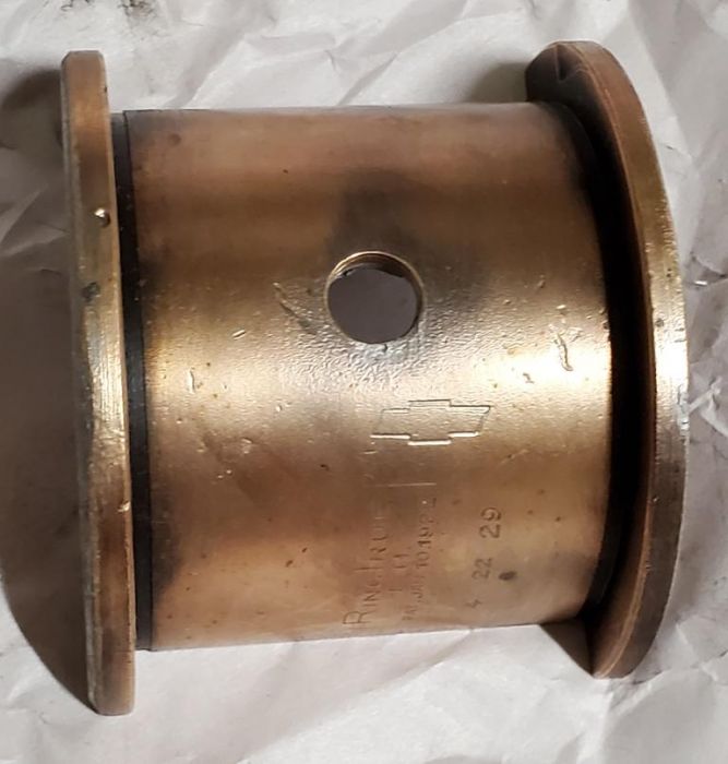

first off was the mains, still love the original Chevrolet Inserts stamped and dated !!
20200212_174102.jpg 20200212_174142.jpg 20200212_174149.jpg 20200212_174318.jpg 20200212_174323.jpg 20200212_174426.jpg 20200212_174622.jpg

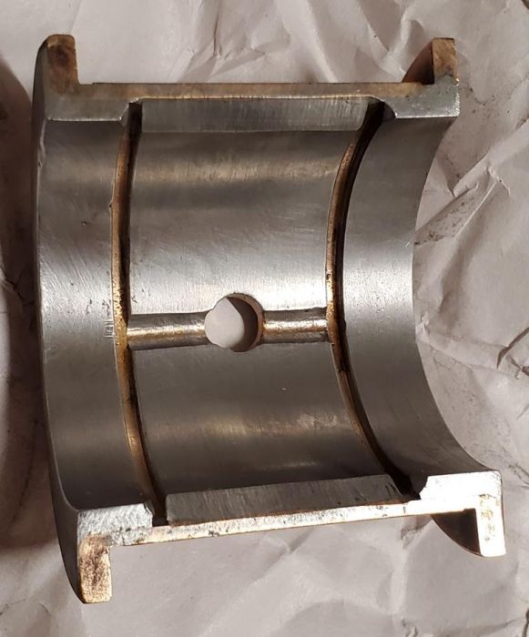

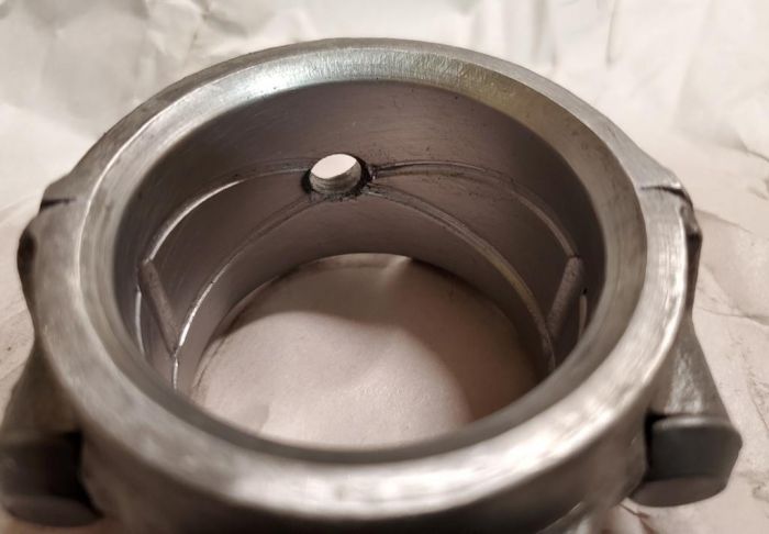

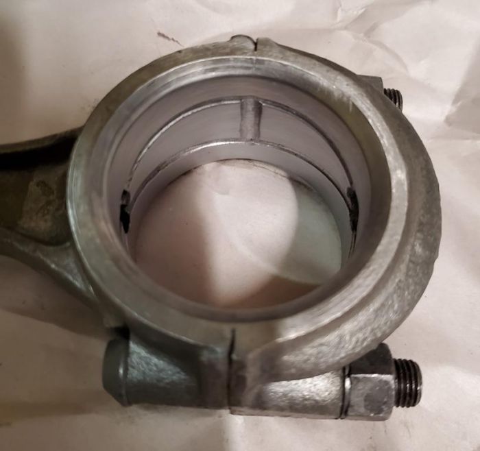

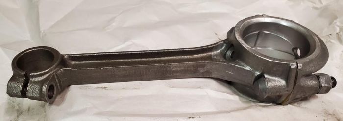

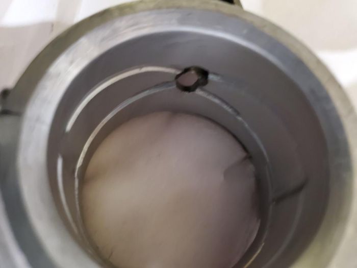

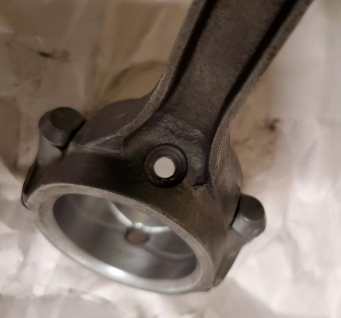

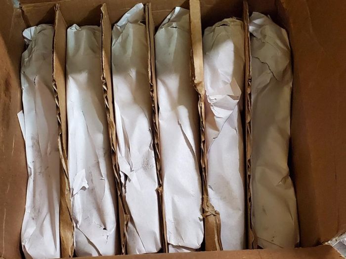

under the mains were the connecting rods, packed and wrapped nicely....

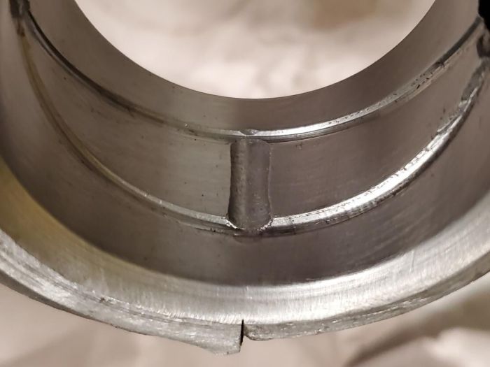

unwrapped each one to check and they all look great, and about the same
few pictures of the inspection
20200212_174813.jpg 20200212_174823.jpg 20200212_174827.jpg 20200212_174832.jpg 20200212_174827.jpg 20200212_174832.jpg 20200212_174838.jpg 20200212_174857.jpg 20200212_174906.jpg 20200212_174909.jpg

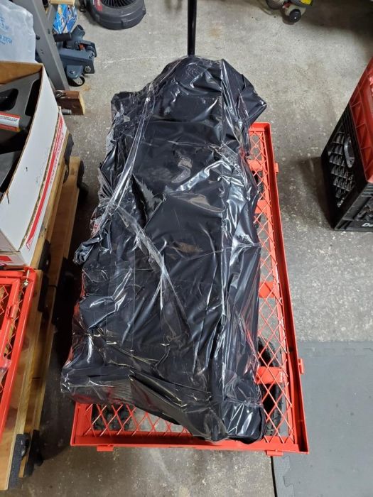

Wrapped up the block, as it was raining that morning, and showers in the forecast anytime.
He helped me load it up, and then we BS'd for a bit about old cars, engines, and whatever...

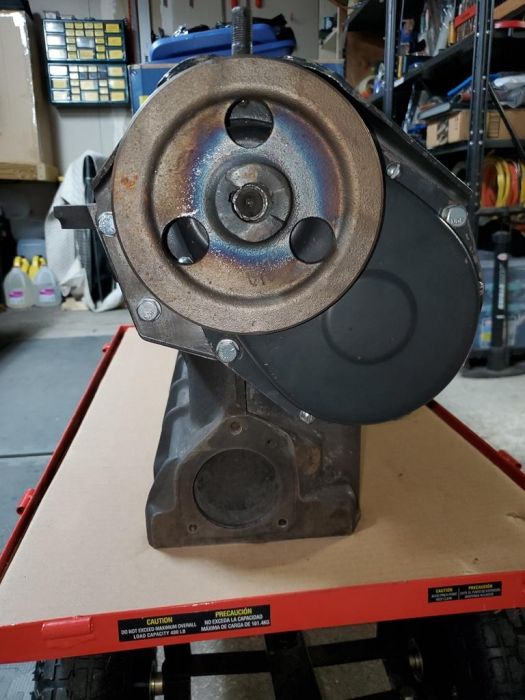

yes that is a 194 inline 6 Cylinder in that heavy duty black plastic wink or so i hope

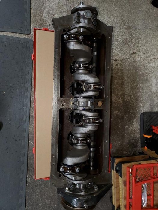

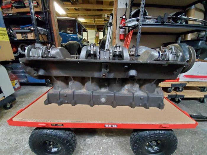

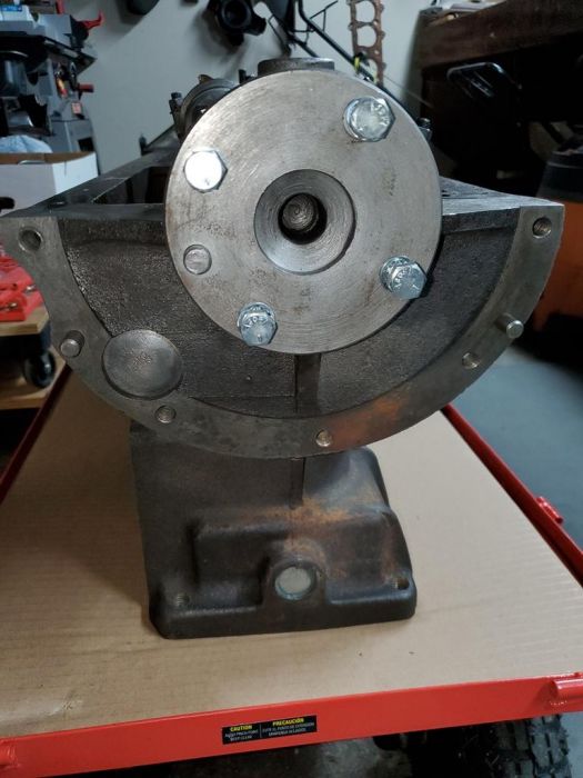

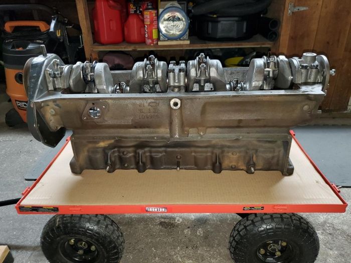

then the main attraction, looks really good inside, will need to clean up the outside and then prime and paint it up.
crank was magnafluxed, turned and ground, same for the camshaft, they had to build up the fuel pump lobe. block was decked and then bored & honed .030" over, installed set of NORS Pistons, pins onto my rebabbitted connecting rods. mains were also rebabbitted and then align bored.

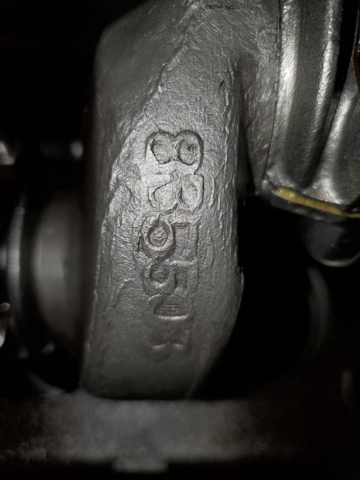

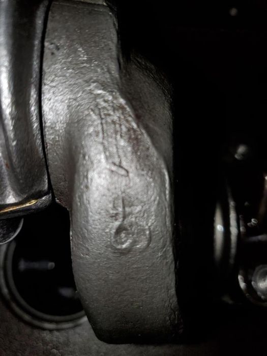

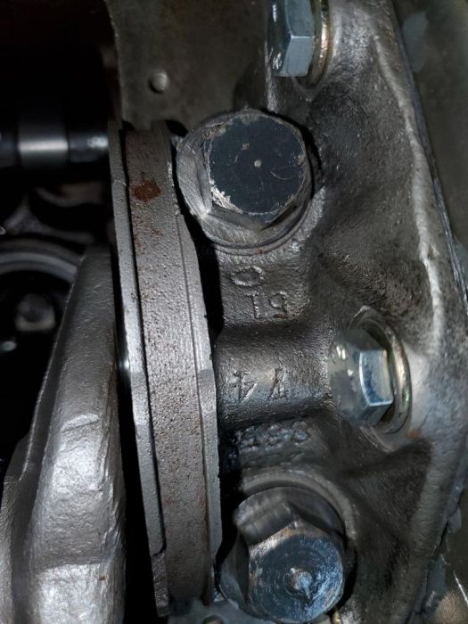

few closeup of the crankshaft and mains. cleaned up and can see the casting numbers and markings !!
20210626_184803.jpg 20210626_184807.jpg 20210626_184813.jpg 20210626_184817.jpg 20210626_184821.jpg

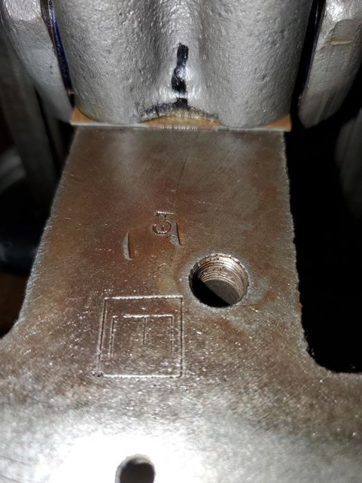

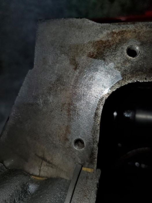

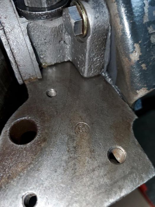

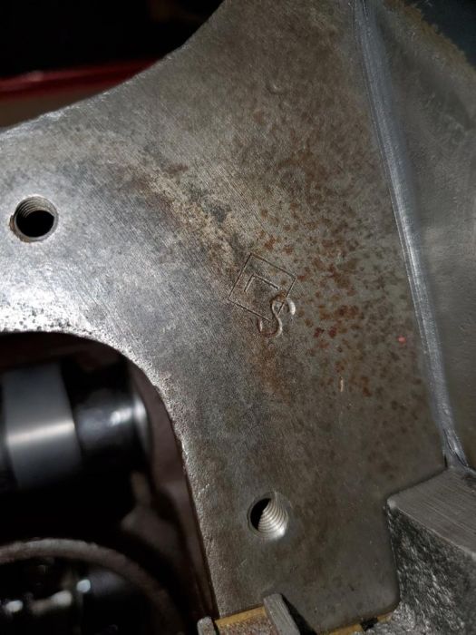

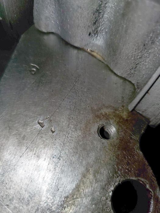

few random markings on the bottom flange of the engine where the oil pan gasket seats.
20210626_184947.jpg 20210626_184950.jpg 20210626_184954.jpg 20210626_184958.jpg 20210626_185001.jpg

Looks like they do very nice work. I don't see the bell housing bolted to the back of the engine. Did they know they had to use it when align boring the mains on these old style engines? Seems to me there was a post where one fellow said his ended up 1/8" off center when they didn't use the bell housing as a centering device. That would sure put a lot of strain on everything.
Art
Joined: Dec 2019
Posts: 1,139
Likes: 75
Joined: Dec 2019
Posts: 1,139
Likes: 75
Good catch Art
I sure hope they just removed the bell housing after the boring was done!
Ole S Olson
they had most everything but the transmission itself for the engine, the align bore was done about a year ago if not longer. everything currently turns freely. can not turn it by hand but it turns :)
he was adamant about having all the parts for fitment and mock up, he made sure everything fit correctly and i even let him use the MPPL & Repair Manual for confirmation.
other perk, and reason i was glad to use him is his dad had a 1931 that they did, and he has done many of these inline Chevrolet 6's
