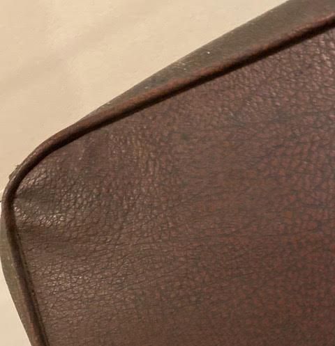

Like This? I have one, possibly two (this one) NOS seat backrests. They both have this covering material. This one is dirty. I cleaned a corner for the photo.

Thanks.
I’ll start looking for a piece...
