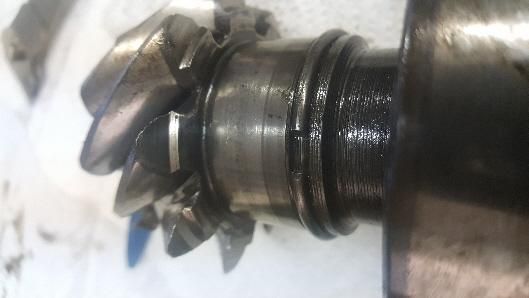

Thanks Dave. Working with Mike right now on drive shaft and bearings. If he doesn't have what I need, I'll get in touch. One thing that is puzzling me is the rear pinion bearing Hyatt OR 1506. Does this bearing have a inner race or do the rollers run on the pinion shaft?

It runs on the pinion shaft.
Joined: Aug 2013
Posts: 36
Joined: Aug 2013
Posts: 36
What keeps the bearing from ridding back into the pinion gear? This happened on this rear end. Take a look at the pictures in the above posts.
Joined: Dec 2016
Posts: 656
Joined: Dec 2016
Posts: 656
Nothing?
Force of habit?
One needs to make sure that the bearing is pushed all the way in for sure, it probably wont do it by itself. Later rearends use a 1/8 inch thick fork tool to make sure the bearing is all the way in. The shop manuals never mentioned it for this rearend, although they did for later designs that used the same bearing. I bought one from the Filling Station, but you could make one. I'm not even sure it will work in this rearend but I think it will. You might be able to get between the gear teeth with a flat nosed punch and do it that way.
I am going to put a drop or two of loctite on mine, but not overdo it, in the interest of being able to take it apart again someday. You could probably use heat from the outside to help release it.
