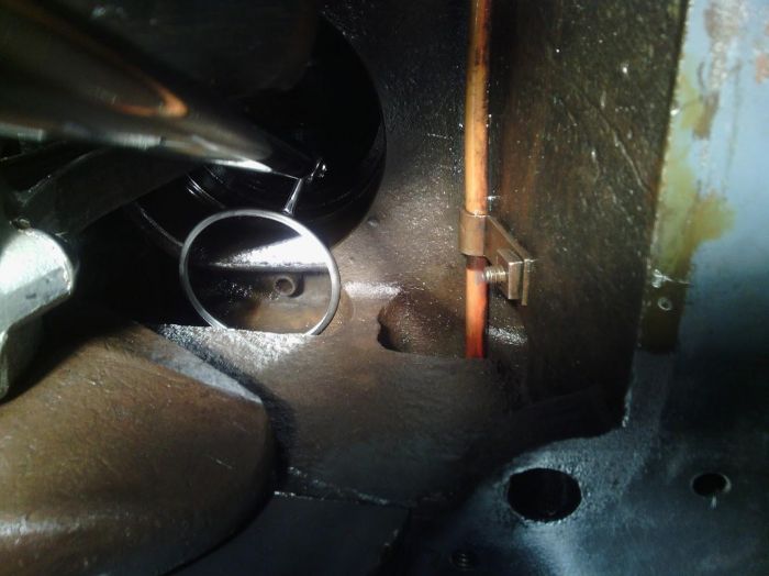

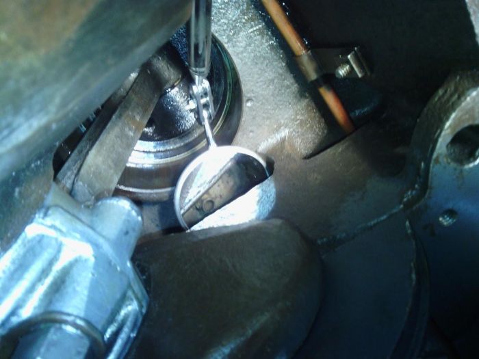

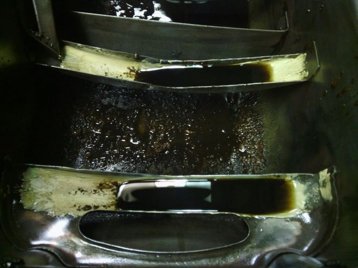

yeah it is a fun diry nasty job with engine in car, been there done that !!
scooped out what i could with my fingers, wearing gloves of course. then flushed with a can of brake clean and a custom bent straw :) had to do all three in the 1929 crap everywhere !! then put it all back together and ran it for a bit, then did it again as there was a good bit of loose debris after the 1 cleaning !!
now that the enging is at shop, we are tearing it down and then cleaning it GOOD !!!
few pictures of the standpipes, and such
