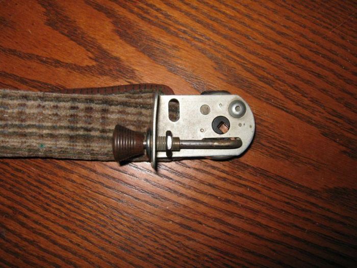

Is there any way you could take a photo to show us what you're dealing with? I don't know what a '41 switch looks like. If it looks like THIS you don't have a button. You need to remove the nut holding the shaft in similar to that shown below. If it looks like THIS you can see the button that needs pressed to release the shaft.

thnx tiny . cant see much . ill try a mirror and see if I can get a better idea . just thought someone else had replaced the wiring as im trying to .
There is a picture on page 282 of the 1941 shop manual. Diffficult to describe.
Go to old car manual project and find 1941 shop manual if you do not have a shop manual. Would advise to order one from the FillingStation if you do not have one.
Good one Gene. That's an unusual critter. It's hard to see the spring clip on line. I think it's best if he buys the manual.
Just feel for the spring loaded device. You'll know it when you feel it with your finger. Push it in and pull on the handle. If it doesn't seem to want to come out, then release a little pressure. You may be pushing the release hole too hard/far.
Use a light and look under the dash and you will see it. It is on the inside edge, toward the steering column.

amazingly simple ,,,,,,,,,,,,,,,,after its out and I can see it !! must suck to be blind ! I had my fingers all over it . now its perfectly clear , but so not what I thought it would be . now if I had a wiring dia. "power in must go to the fuse holder !? never give up ! sometimes its the 10th try!
