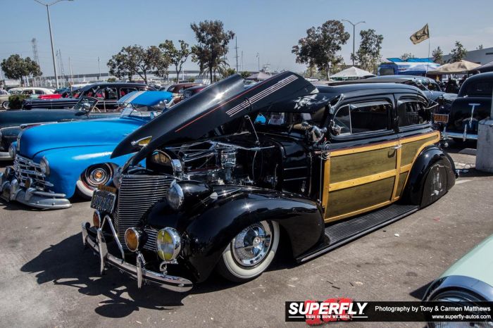

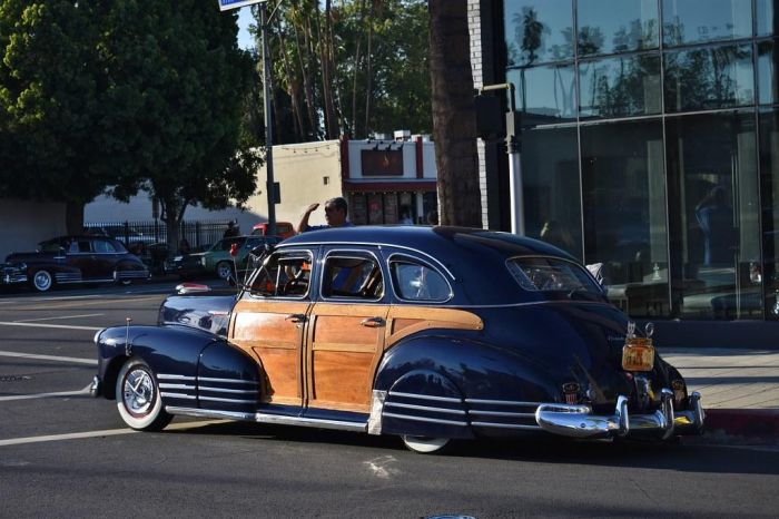

These were not produced by Chevrolet, but some is making them for what ever car you want.
VCCA Member 51121
This is what is called "customizing". They'll probably turn up in the "Personalized chapter".

I don't believe Chevy or any other GM division sent completed 4-door sedans to be converted to woodies. Chevy at least, offered a passenger car chassis with floor, cowl, A-pillars, windshield, and front sheet metal attached that were then bodied by an outside source.
