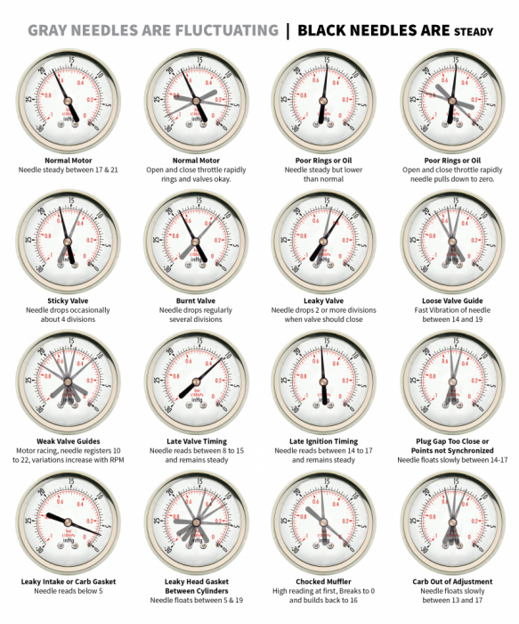

Did a vacuum test on the 1929. The results are as follows, Vacuum at idle 18 psi but is not steady fluctuates rapidly about 1psi. The best running is when the carb idle adjustment is seated fully clockwise. I suspect a leak at the carb any comments appreciated.

Rapid fluctuation isn't usually carb, but I've been surprised before. Have you checked for vacuum leaks, done a compression test, and (even better) a leak down test? Closest on this chart to your symptom is a loose valve guide. Let's hope it's not that. A leak down test should help isolate valve issues, if any.

IB, I'm still thinking it may be a valve-related issue with the vacuum gauge showing rapid fluctuations (which is not typically a carb issue). If that is right, driving as-is could make whatever is going on worse. Easy to do compression and leakdown tests seem in order to rule that out.
