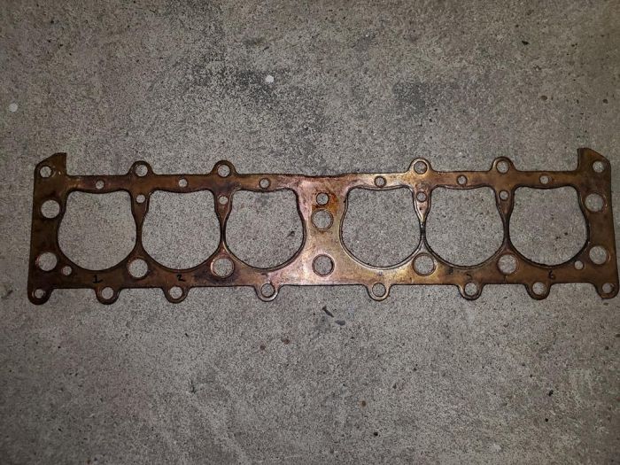

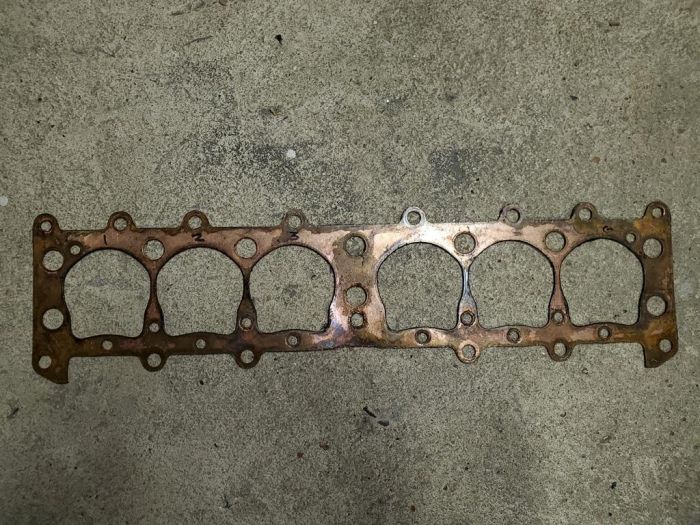

todays venture was machine shop calls... trying to get all my ducks in a row so when i pull the head i can go get it magnafluxed. figured IF i am pulling it, I am going to get it checked. found a few local shops that do that thing, and can machine it if needed, 1 of them can do the cast iron welding, the other 2 have a shop outside that does that for them. magnaflux cost run from $25 to $65 and can be done in a day or two. some also offered to do a pressure/vacuum test to test for porosity and pin holes.that is additional cost, approx $50.
now jsut have to remove everything so i can remove the head... love back pedaling !! oh the joys.
and just to think the PO told me the engine was completely rebuild... Not today sir, not today. considering that they had a complete valve job done, would figured to get a magnaflux to be safe. who knows maybe it is something else. but all signs are pointing towards a cracked head.

Hoping for the best for you. Where there any signs of gasket failure? That would be the best scenario at this point. I had my block hot dipped and magnafluxed before any work (the machine shop insisted but I was going to have it done anyway). Even with that I pulled out a pound or so of crust and hardened sludge out of the cooling passages. Same with the head. Than fully both the block and head tested good. My biggest expense was the crank which I had built up and ground back to size. Fitting the connecting rods and pistons now but I had a disaster with the crankshaft pulley and need to find another. Curious what you find?
that is how i would have approached it and now kicking my self for accepting the engine rebuild by PO. babbitt is new and looks good, valves are new (not correct but work) and look good. but the more i get into it the more i go crazy. should have just had a complete make over or at least an experienced shop go over it, inside and out.
i may be heading down that road now... pulling and starting from square 2, unless i have to start at square 1. no local shops around that are experienced in antique chevrolet engines around here :(

Disappointing that it has not been rebuilt but at least it's a solid, healthy start and not .080 over and tired. It does look like the head gasket was possibly allowing coolant to get into at least a couple cylinders so head could be fine.
If you found it ran decently, you might be able to defer a rebuild and just get the head done and new gaskets. You might get a few summers running before rebuilding as I know you've spent a lot of time and money on other things while believing the engine was fresh...
