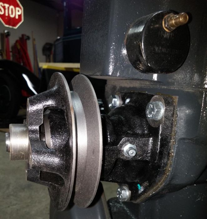

Air getting drawn in around the water pump shaft packing.

it is the NEWer style water pump from TFS with bearings

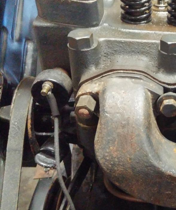

Are you using the original '29 head with the electrical heat gauge? If so, it only has four positions and is not a very accurate indication of how hot the engine is. Better than nothing, but not much better.
All the Best, Chip

original head, seems to be later production valve set up, and looks to be the stock stock temp gauge, with 1 wire.

Yep... looks just as it should to me.

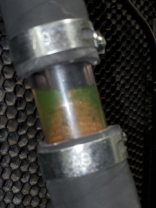

well too kit out for a small trip to the local drive in with local AACA club, about 6-7 miles from the house most all back roads, kept it around 25-35. car ran nice, smooth around around those speeds. temp stayed in the alc boils range, never above, even sitting at stop lights. when i got there and parked, (no hood still) i noticed a small amount steam/ smoke coming out around push rod cover and more so out of the oil fill tube. not a lot but a small trail easily seen. group ate, chatted, had ice cream then i headed back home. car was nice and cool when i left to go back. same trip home, parked in driveway and same trail of steam/smoke when i looked at engine. also noticed that the coolant level was down, i could see it in the Gano filter. when i left i had it about 1/2 above the top of the core in the radiator, once back home and cooled off about 4 inches lower. never puked or dumped when i parked at diner, or back home. so assume it is blowing it or burning it.
