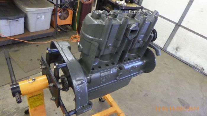

I am about to do some work on a 28 engine. How are you guys mounting the engine to a roll around stand? I have a bracket used for Ford Model T and A's (can't use on this engine) that fits in a normal stand and probable can figure something out, but it would be nice to have at least and ideas to work from.

I left the cast iron flywheel housing bolted to the block and mounted it to the sand using it for my 1929 engine.

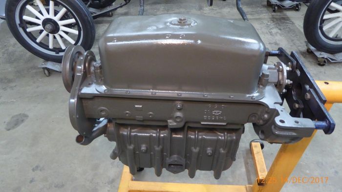

I also kept the flywheel housing on and used a 4 wheel engine stand.
I used a regular (cheapo) engine stand when I rebuilt Lurch's engine two years ago.
You can see a pic of the setup at the beginning of the rebuild thread: Resurrecting a '28 4 banger

Great and thank you! So use to mounting Model T engines from the side, mounting from the rear didn't even cross my mind. I did some looking at the resurrecting thread in the past and again now. Thanks for that link. While I never did get it put back together, the very first engine I tore down many many years ago was a 28 so at least I have a clue what is inside. :)
