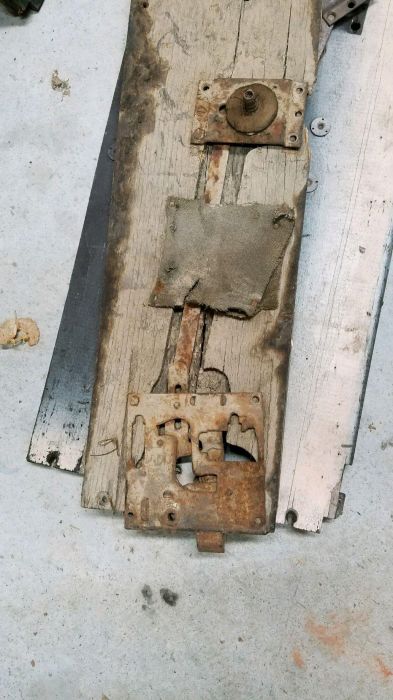

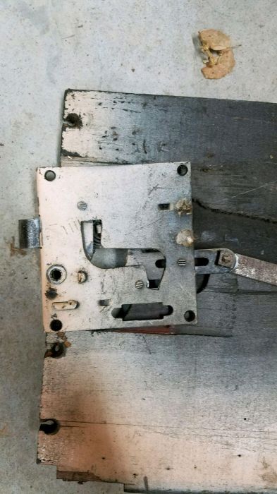

Here are a couple of pictures of 31 door latches. The rusty one maybe earlier. Do yours look something like these? If not I have a box of these somewhere and might be able to help if you know what you need.
