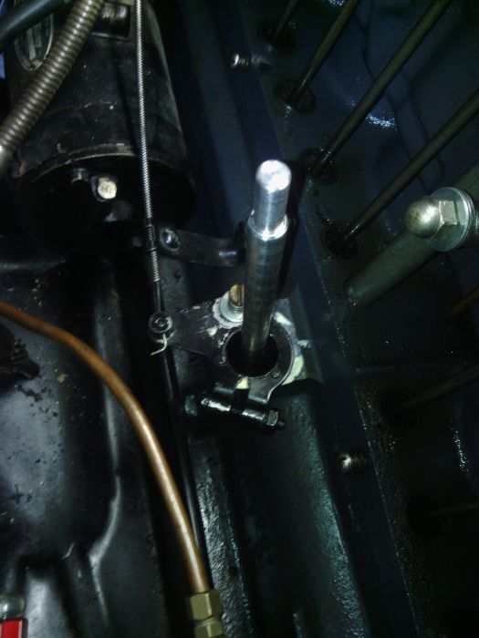

Engine was lubed/coated for long term storage on reassembly. also put in a little oil in the plug holes for security
I will have my 6v timing light by my side on fire up when i do the fine tuning
i have a priming tool i use to prime the pump and get oil flowing :) quick and easy process for that one
