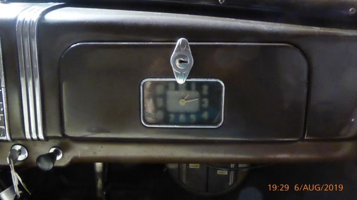

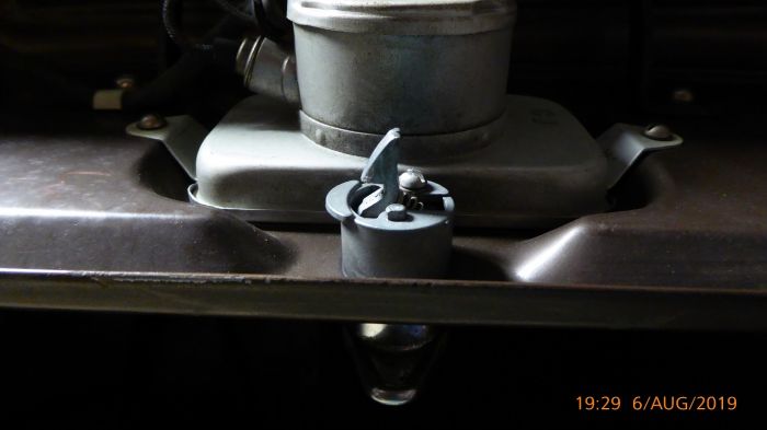

See if the winged handle is loose enough in the door that you can rotate in either direction. You might want to use some penetrating oil and turn gently with hand pressure so you don't damage the lock case. Once the Wings are vertical the latch hook should disengage from the bracket and you can open the door.
This is just an emergency approach to get the locked door open without a key. Once the lock is working the wings are set horizontal and they are only used as finger pulls as other have mentioned.
Tom
