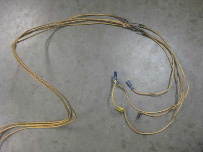

It is pretty obvious that a new wire harness is called for with your electrical problems. I justify this on your previously posted pictures and the problems you described above. 4th Posted Picture . I am assuming most of the original 68 year old wire has been piecemeal replaced with and oddity of newer wiring but not all. The attached pictures were of a section of my 41 wiring, concealed by my headliner, before I replaced my entire wiring harness.
Good luck, Mike
