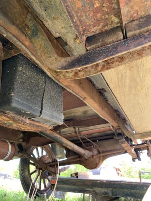

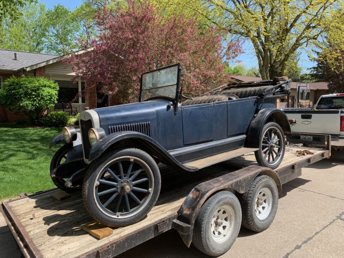

Arnold if you lived a little closer you could get some measurements from my 25 Superior Series K Touring. Almost all the wood is in great shape. Mine is an early 25. My dad always called it a 24 1/2. You are welcome to get any measurements you need if you come to Iowa.
