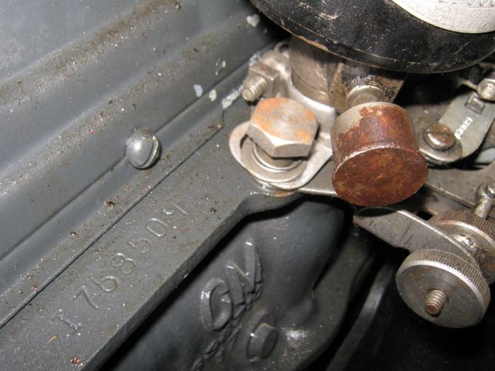

The engine in my 38 Master Sport
I560895
