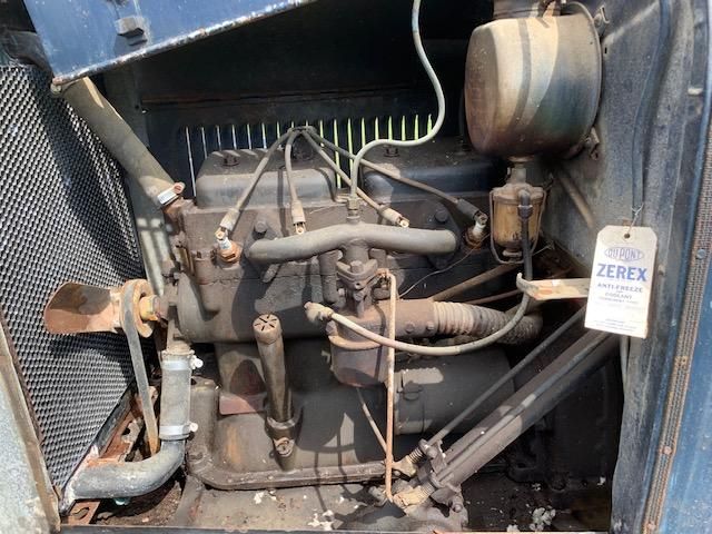

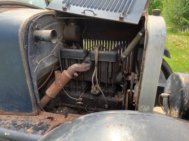

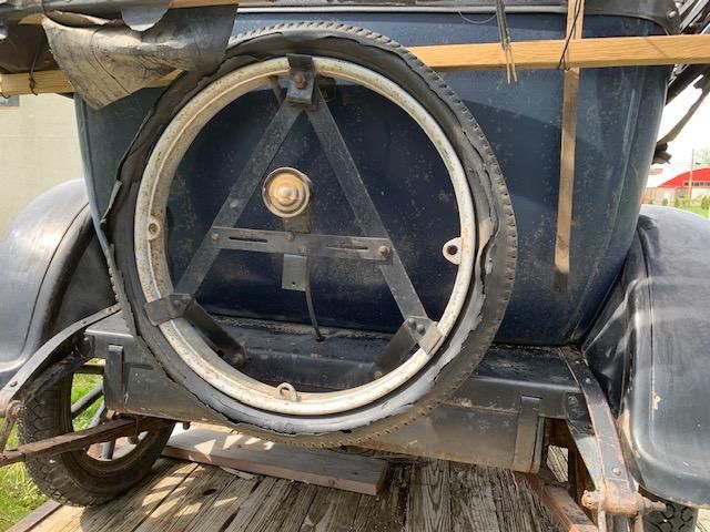

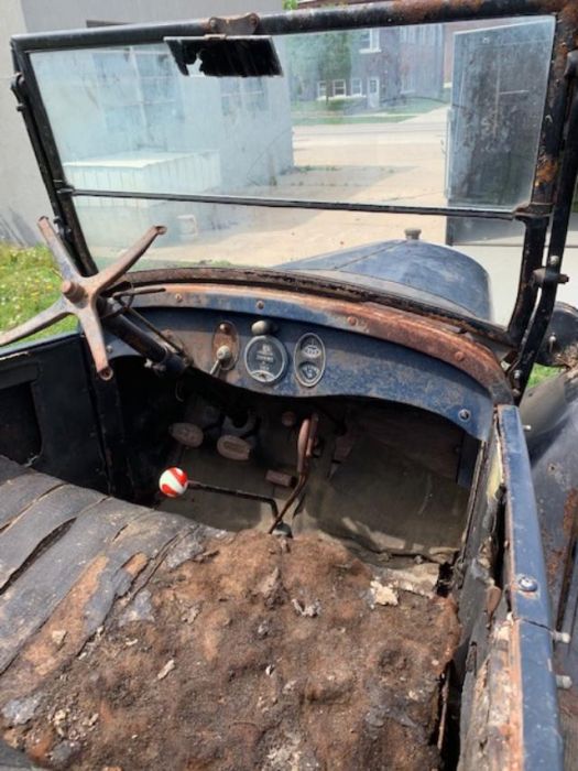

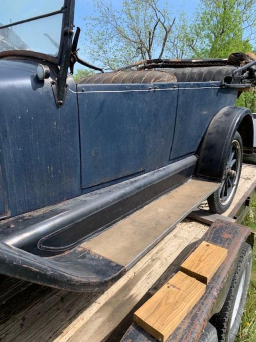

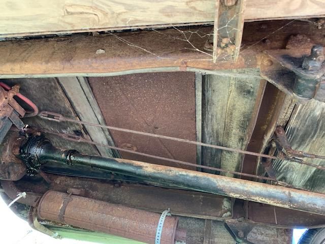

I wish there was some one that could get it running. It would be great to be on that tour but my wife is not into cars like me. She does like the car but.... Woops I lied. After looking at the pictures it has 38,919 miles on it. I am gluing the steering wheel back together because it dried out too much. As you can see the wood and floor mats are in great shape.

John it looks like you have a very expensive decision to make. Buy a 1926 radiator and generator or buy a 1925 engine. There is no place to hook up the gen/oil pump/ distributor assembly on that engine. The lower radiator hose was moved to the passenger side in 1926 so the generator could be mounted on the drivers side. I wish you the best with your project.

John, It might be easier it find a '26 radiator even if it is damaged. All you would need to do is find a radiator shop to swap the lower tank if your radiator is in good condition. The generator shouldn't be too hard to get. NOTE: Find a radiator shop who knows how to work with the old radiators. I had a new core put in mine. They said pick it up in two days; it took a week. It was a family owned business and they had to bring the grandfather out of retirement for a day to teach them how to do the job. Too much heat and the core starts to fall apart. Good luck.

That might work Steve, but I'm still missing the distributor and oil pump. My dad took them off back in the 60's to try to get some one in California to machine a new oil pump. The guy died and his widow didn't know where ours was. Then my dad died and left me with this incomplete car. As you know the 25's were the only year for that combination.

John; my mistake. When looking at your pictures it looked like the distributor was in the block. I photo shopped it and lightened it up and had a better view of it. I thought you had a '26 or '27 engine in it. So forget my suggestions. I have an after market oil pump if you can't get one locally.
