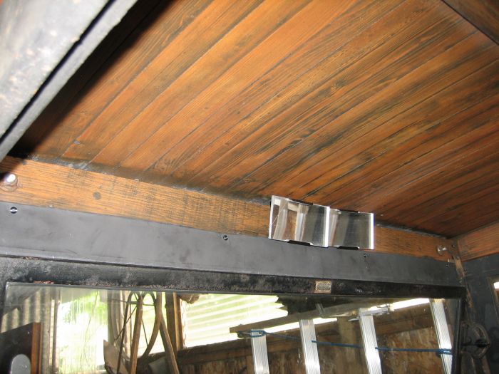

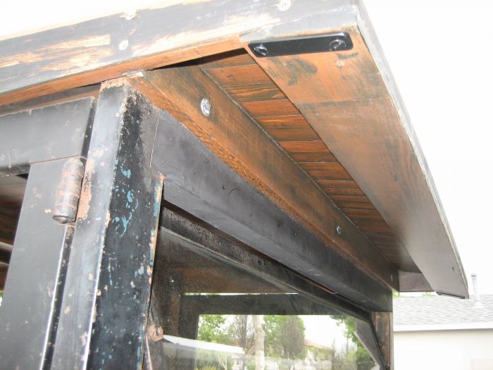

Hi all,

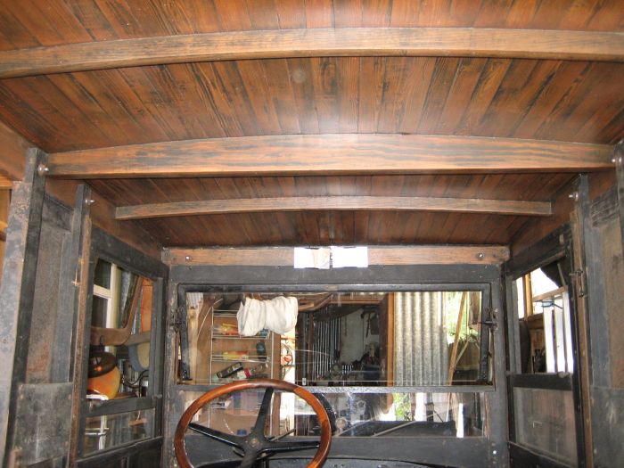

Sorry for being late to the party on this one. I've been very busy finishing an art project for the Welding for Artists class that I've been taking. I included a photo of my project along with pics of Justin's roof slats below. ;-)
My experience with wood roofs is limited to just one: Justin's (1928 AB Canopy Express with body by Hercules). Being a canopy express with the roof going all the way to the back end of the truck, I have no info about the back of a 'short' truck cab.
That being said, Justin's roof slats are Oak and are 1 1/2 inches wide by 3/8 inch thick. There are 32 slats. The cross members are clear Douglas Fir.

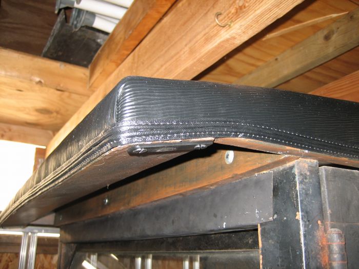

When I got the truck, the fabric was not on the top and I noticed that some of the nails that held the slats down were loose and coming up. So, I pulled all the nails for the first two rows and replaced them with screws. I counter-bored the holes in the slats just enough so that the screw heads were below the top of the slat surface.
I also repaired some holes that were broken out by gluing in dowels and re-drilling the holes. The backmost cross member had a bazzilion nail holes in it from previous roof fabric installations. I glued a toothpick in each nail hole with Gorilla Glue and then cut off the toothpicks thus restoring the integrity of the nailing surface. ;-)
Oh, the previous owner rebuilt the roof back in the 1970's and painted the underside flat black. I didn't like the way that looked, so, after I did the wood repairs, I took it (the roof) to an artist friend who stripped the black paint off and gave the wood a satin clear coat.
After putting the roof back on, I purchased roof material (Cobra long grain vinyl) from one of the Model A vendors and took the truck to a local upholsterer who installed it.
Separately from the roof repair and new top, I had a car cover made for the truck. Attached is the paperwork for the cover, which includes dimensions of the overall truck.
Disclaimer: These dimensions represent the truck as I got it. I do not know if the roof is a complete, authentic reproduction of the original.
Hope all this helps. Dean

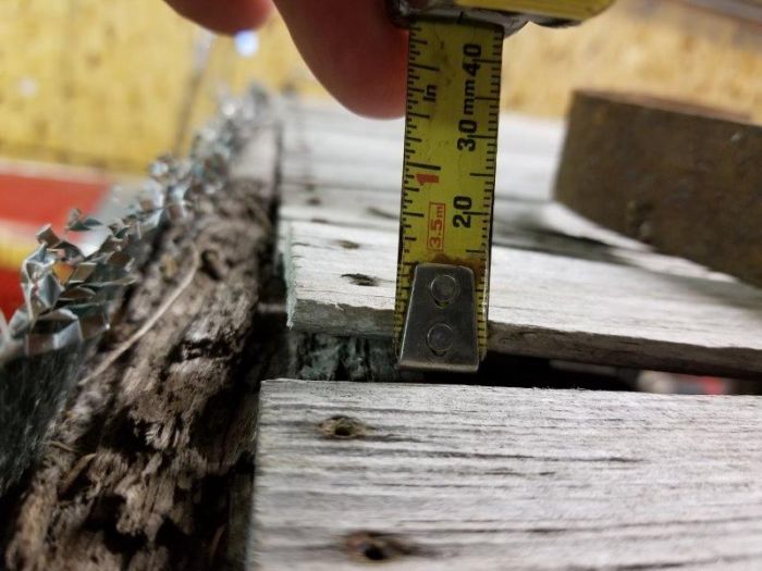

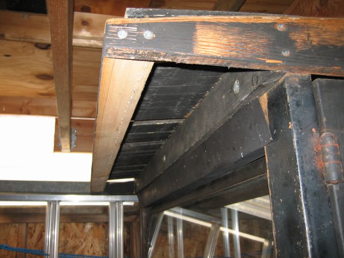

this is a 1928 1-ton truck. i can not say with certain itis original but this is how it was when we got it in 1960.
[Linked Image from i.postimg.cc]

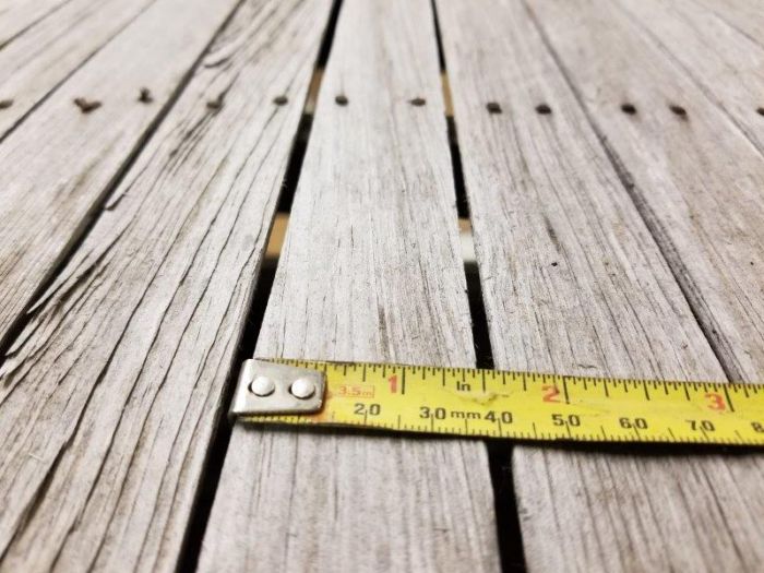

they are 1.5 inches wide (the end 2 are tapered to match the roof curve)
i used a metric tapemeasurer for all you metric floks
and they are real thin.

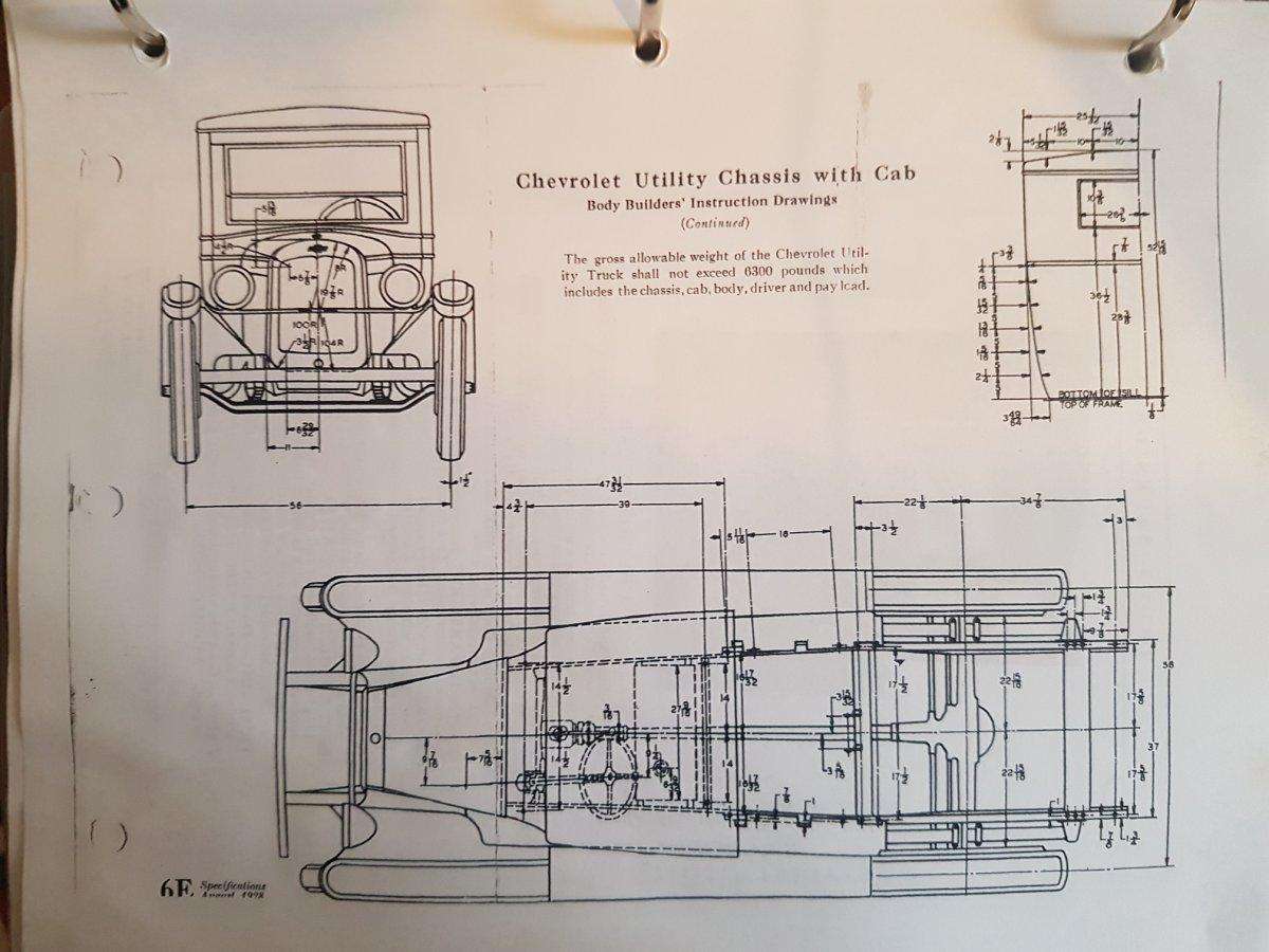

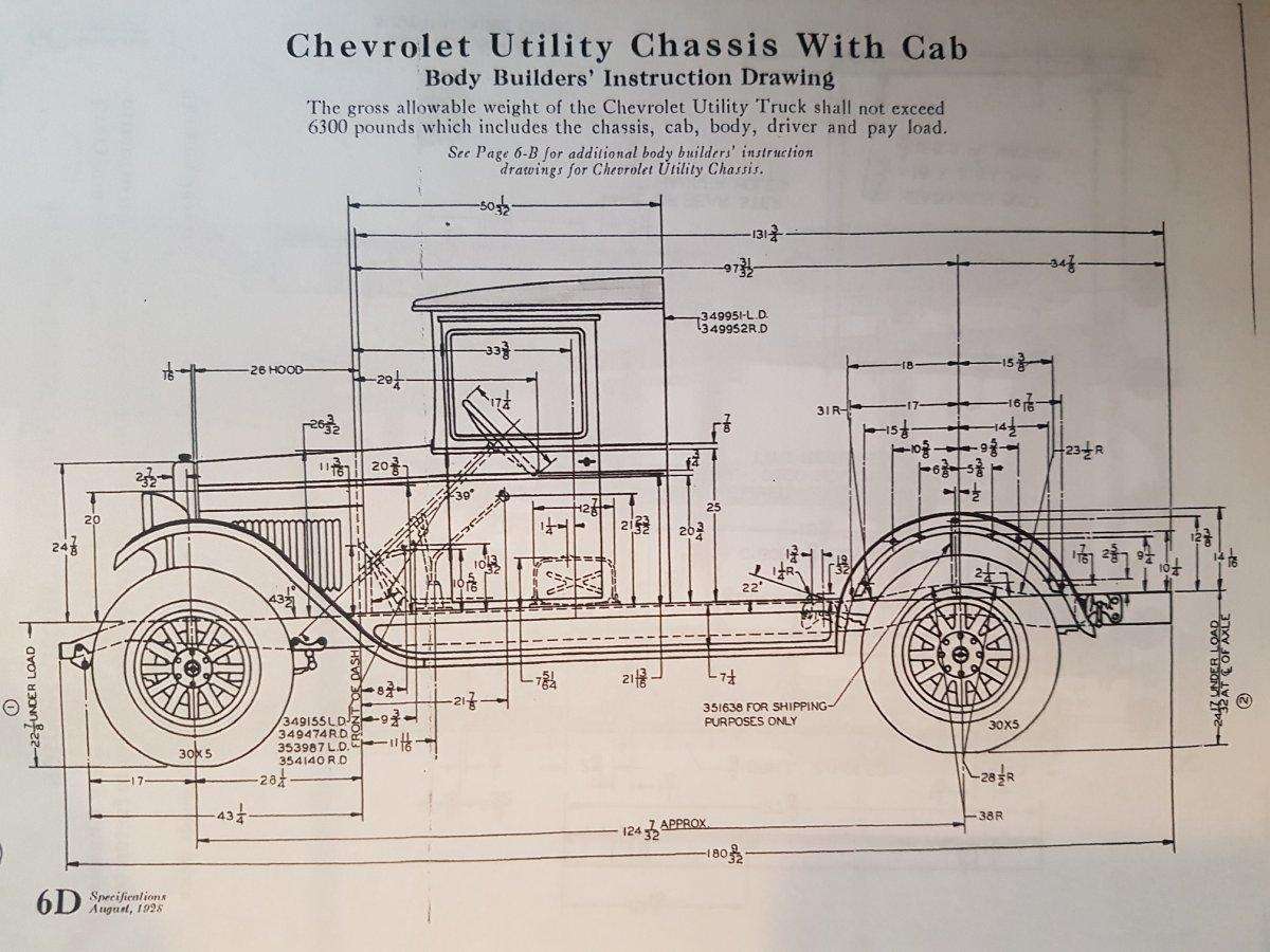

I have a question not about the slats, but the bows and I'm posting it on this already started thread for two reasons. One because it has some good reference pictures, and two because I have personally seen Mike Didier's truck and took measurements off it. Unfortunately, I did not measure a couple things that I need, and I also question I guess.
From looking at Mike's pictures and the pictures I took of it, it appears that the rake from front to back is in a relatively flat plane down the center. I have seen other "restored" trucks on the web that make it look like the rake has quite a crown to it. Also on this dimensioned drawing of a factory Chevrolet cab you can clearly see a crown from front to back. (and I included a drawing I worked off of for the back starting arch)
So question is should there or shouldn't there be? I started making roof bows with a crown (just have two done from the rear forward) Esthetically I think the crown looks better, but I also want correct?
The other question is how thick should they be, and how tall? The ones I have made I cut from a full 1in thick board I planned down, and I made them 1-3/8in the tall. IDK what I will have for a crown from front to back. I will have to measure.
