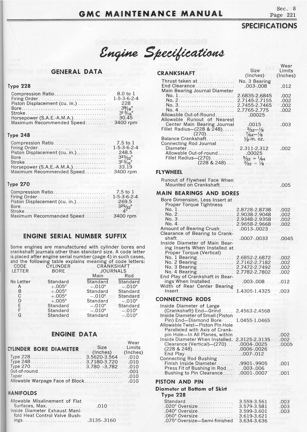

A228458059
A = Cylinder bore is +0.005, rod journals are -0.010 and bearing journals are -0.010
228 = 228 cubic inch GMC inline
458059 is the regular sequential serial number for that motor.
The 228 was produced and used in US production GMC light duty trucks from '39 until 1953
Engine s/n prefix key is about mid-page in left column.
[Linked Image from oldgmctrucks.com]
