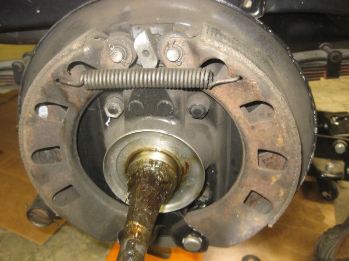

I have been having trouble with front brakes dragging to the point where I can't move the car. This only happens in REVERSE and on both front wheels. I back off the brake adjusters (way back). The wheels turn freely. I try to back the car before touching the brake pedal and I can feel the drag. The spindle nut is installed hand tight. The drum seem solid and doesn't move.. I have had the wheels apart several times and when I reassembled I place the tapered end of the outer bearing inward although it seems that it fits both directions (see photo) This one's got me stumped. Thanks for any ideas.

I can't tell from the photo which bearing you are referring to inner or outer. You should have the inner ball bearing assy facing outward and the outer ball bearing assy facing inward. I am not familiar with the brake set up so can not help with that.
as for brakes if you look at the shoes are the pads dragging all the way around or just on one end or the other ?? also check to make sure the drums and brakes when set up are round not oval/ eggshape.

Thanks for the good info. I was talking about the trunion. Here's my theory; After backing the trunions way off, the wheels turn freely off the ground with no drag from shoes Then I remove the jack stands and place the wheels on the ground. At that point, I don't touch the brake pedal. I put the car in reverse and within 5' of travel, I can feel the drag. Putting weight on the wheels seems to play a role. I thought that maybe the bearings were some how causing the brake drum to "wiggle" which may have caused it to bind on the shoes. But then again, I didn't get any play when trying to wiggle the drums by hand. .Question; in your photo, the outer bearing is mounted with the beveled side toward the backing plate, right? I will look for the service news article. I believe that I have it. Thanks again.
