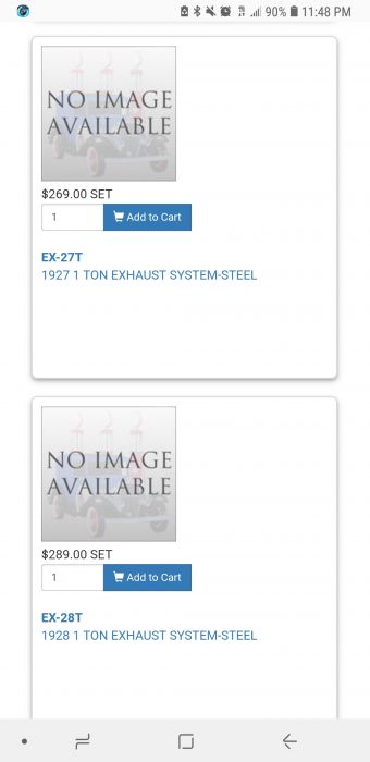

Is there any difference between a 1927 and 1928 1 Tom exhaust system? Send pictures if you could. Thank you. please please

I don't have pictures. There is indeed a difference between 1927 and 1928 exhaust pipes. That is due to the center dump from the single exhaust port in 1927 and the rear dump two port 1928 exhaust manifold. The muffler and short tail pipe would be the same.

So if I have a '28 head on my '27 truck I need to use the '28 exhaust system then? That seems to make sense.
