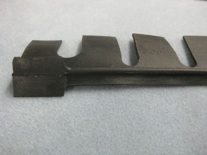

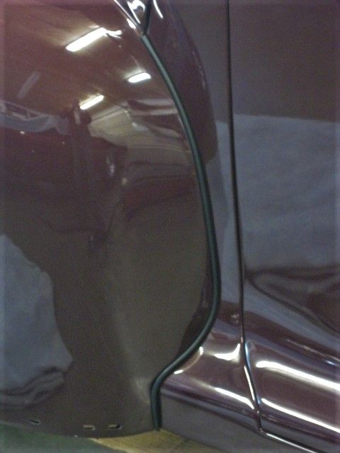

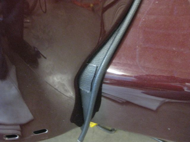

For the 1941 Steele makes rubber fender welting (anti squeak) to fit the front fenders. I tried, unsuccessfully, to install them and finally gave up and used the same welting I used for the back fenders. The problem with the rubber was that it sticks to the fenders and body when trying to make small adjustments with the fender in place. I tried using soapy water to lubricate the problem areas but even that did not work well. The rubber is at least 1/8" thick and as the bolts holding the fender are tightened the rubber can expand out of place. It also does not look like the back welting because of its dull surface, and is not molded consistently with a smooth looking fit.
Hopefully, my pictures illustrate the problem. I bought my welting several years ago and it was expensive (over $100). I see it is now available for around $15.00 a pair from Chevs of the 40's. Steele did refund me my money. I Superglued small felt pieces to the welting to further assist in alignment.
Thanks, Mike
